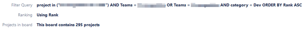

The filter for the board has 295 projects... (yes, I know it is stupid, but this was put into place way before I cam eonboard here), but the actual sprint has issues only from 6 projects all of which I checked for the necessary permissions and the appear correct. Is it possible that not only issues included in the sprint, but all the projects on the board need to be correct? Because that would be a major effort to check them all.

We have a system where department leads have across the board access to all the projects (all 295), and only some of them are facing the problem of not being able to manage sprints. But the others can manage sprints across the board.

Hi @Gergely Groupama
Given the Board filter references all Projects (i.e the field data after the OR could be any Project, not just 6) - Department Leads would need the appropriate Permissions in all 295 to manage sprints.
