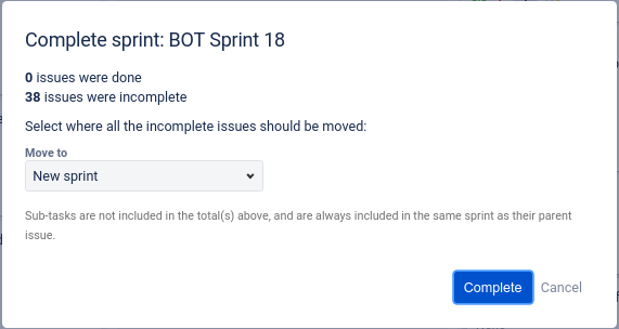

Hello All,
Our team recently completed a sprint.  We have many completed items (Done -Tested) swim lane) and there are a few still in QA.  I clicked the COMPLETE SPRINT button, but it reads that 0 issues were done and several are incomplete. What do I need to do to change this?  I planned on moving the incomplete items (since they are required) to the next sprint.

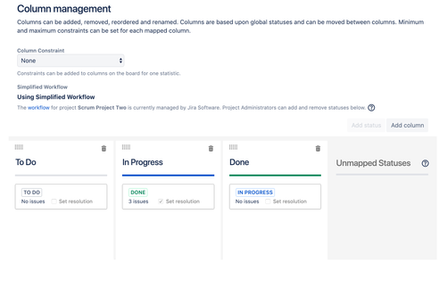

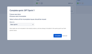

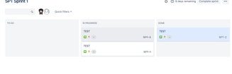

Hey Tomeka,
It's important to make sure that if you want your items to be considered as "Complete" in a sprint, they need to all be in the right hand most column. Any items that aren't in the far right column will not be considered complete by your sprint regardless of the status category.
As an example: In my board configuration, I have my right hand most column mapped to the status of "In Progress" and the middle mapped to "Done". This is normally not advisable, and I'm only doing it to illustrate that the columns are what determine "Complete" vs "Incomplete" from a sprint perspective.
Even thought my tickets in the middle column occupy the status of "Done" becuase they aren't in the right hand most column, two of my tickets are still considered incomplete when I go to complete my sprint.

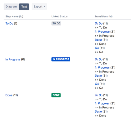

I see tickets in the right-hand column.  But, how do I verify the mapping so that DONE is really done?
I see the following in the workflow, but am not sure where or how to make the changes:
Thanks for your help.

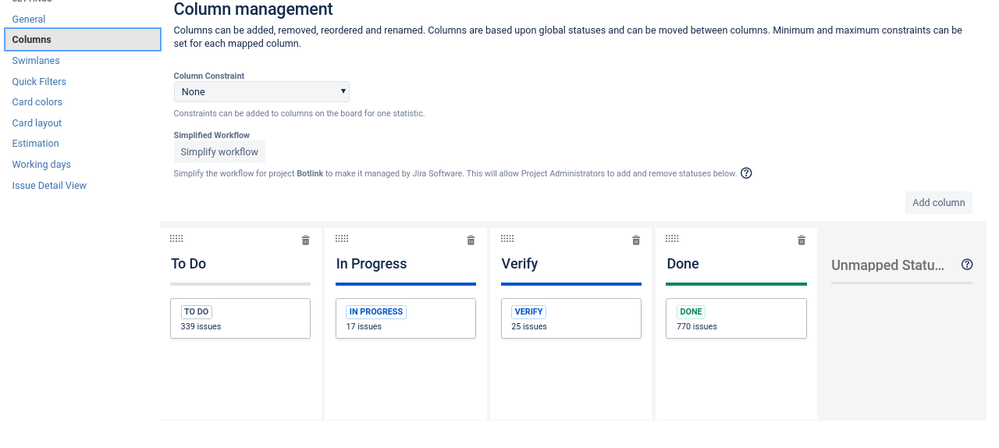

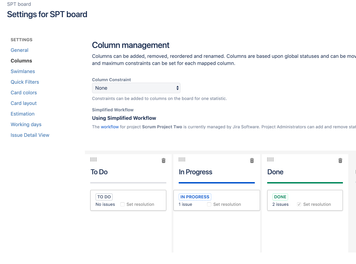

Kian Stack Mumo Systems
February 5, 2019
Your workflow is fine as it is.
The issue is the board configurations. Navigate to your board, and go to the upper right hand corner. There should be something that looks like "..." . Click on that, and go to "Board Settings". Navigate to the Columns section, and validate that "Done" is in the right hand column.
It should look like this.
Paul Klapperich
May 13, 2019
Mine looks like that:
columns.pngBut when I got to close the sprint, it says 0 issues are done:
Is there anything else that can be causing this?
