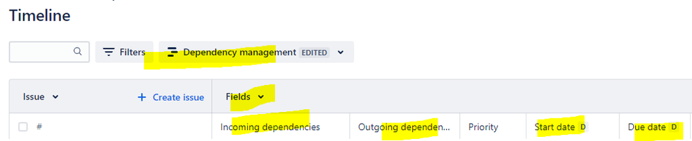

you just need to create some initiatives (depends on how many projects you have running and size of each one) then create epics (in case you dont have ones already) and link those epics to the initiatives accordingly using Parent Link field.
create a filter in Jira that gets you only initiatives and epics (in case you dont want to see lower level details)
Head to advanced roadmap and create a plan based on the previous created filter.
in the roadmap, select dependency management view and make sure the below highlighted fields are showing. if not, click on Fields with an arrow next to it and add them
start by adding start/end date for each epic then add the relationship between them, like SF, SS, FS, FF.
of you course you can do the above for the Story level as well subtasks, depends to which level you want to see details in your plan. you can control that from your main filter you created to include what you need.
hope the above helps, please let me know in case you have any further questions and i would be happy to help.
