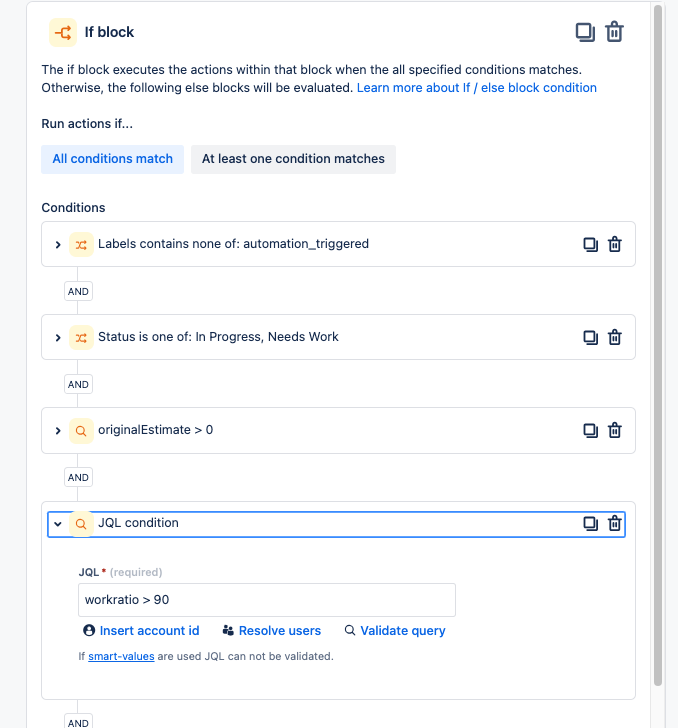

Joana Rocha
April 15, 2024
Hi Annamaria,
I used the fields and values directly from jira.
Here's a screenshot, hope it helps. Let me know if I can answer any question Screenshot 2024-04-15 at 13.13.11.png
Annamária SZITÁS
April 15, 2024
Hi Joana,
It worked :) Thank you for your help!
Regards,
Annamaria
