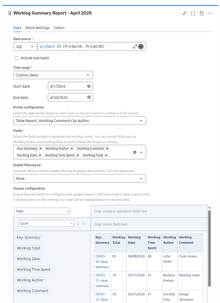

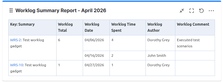

If you're willing to try an app and have Jira Cloud, the Advanced Edition of our Great Gadgets app offers a Worklog Reports & Timesheets Gadget that does exactly what you need.
To get a report like this, all you have to do is add this gadget to a Jira dashboard and configure it like this:
Alternatively you can use the same gadget in Confluence Cloud. The gadget is localized in Spanish.
