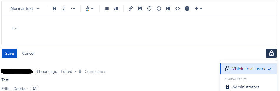

What i have noticed after trying to replicate the same problem from another project is that there is a Lock icon when making a comment on the issue which only appears to make this duplication when set to "Visible to all users" is this a feature I can remove or disable?

Okay so I have found the solution, we had an app installed into Jira which was causing this issue.
