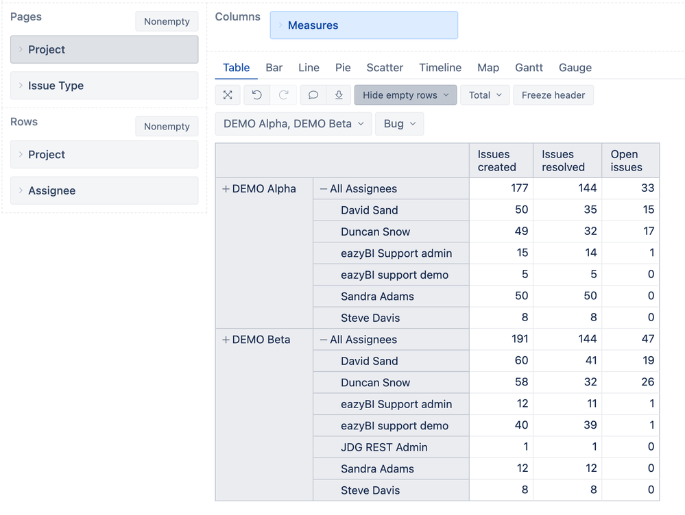

@Gaurav J'ai essayé regarder la documentation de EazyBi mais je ne vois pas ce que je veux réellement

Hi @Absa Thiam
For the particular eazyBI report on bugs by project and assignees, use dimensions "Project", "Issue Type", and "Assignee". On the columns, select measures "Issue created" to see each assignee's total amount of issues. You can also select measures "Issues resolve" and "Open issues" to see the progress. For example, the report might look like in the picture below:
Sometimes it is easier to start with examples. Please check out Demo account with several ready-to-use repro examples: https://eazybi.com/accounts/1000/dashboards/51711-start-simple.
I would recommend watching a training video (12 min) on how to build reports to cover the main concepts and possibilities: https://docs.eazybi.com/eazybi/learn-more/training-videos#Trainingvideos-Episode3:Startbuildingreport.

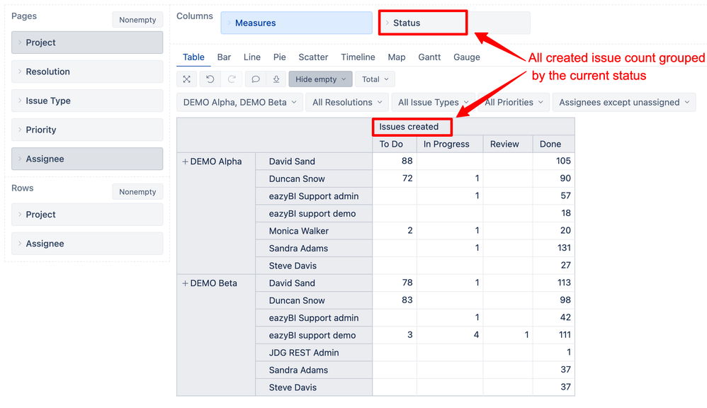

@Absa Thiam, thank you for your interest in the eazyBI app! There are many possibilities for what report you can build.
eazyBI offers two dimensions, "Status" and "Transition Status", to analyze issues by their statuses. Each dimension is designed for a different purpose. For example, use the dimension "Status" to group and filter issues by their latest status, but the dimension "Transition Status" to analyze status change history and time spent in each workflow status.
If you woudl like to see the issue count grouped by their current status, then add the dimension "Status" and measure "Issues created" on report columns (here is documentation on mentioned measure and dimension: https://docs.eazybi.com/eazybi/data-import/data-from-jira/jira-core-measures-and-dimensions).
More report examples of similar use cases with the dimension "Status":
If you would like to see how much time each ticket spent on each status, then you might want to use the dimension "Transition Status" and measure "Days in transition status" (here is documentation on mentioned measures and dimension: https://docs.eazybi.com/eazybi/data-import/data-from-jira/import-issue-change-history).
Report examples on similar use cases:

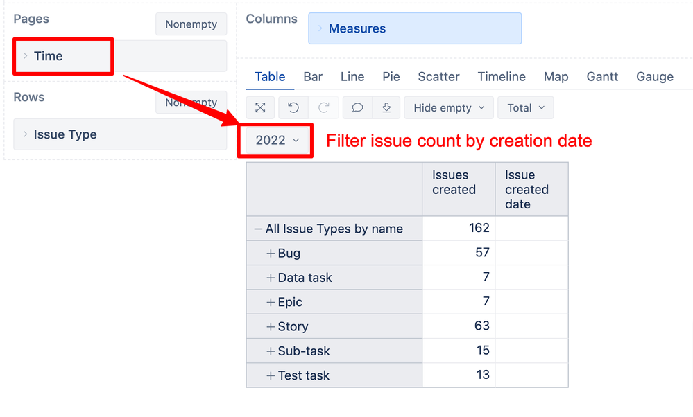

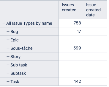

Bonjour @Zane eazyBI Support j'aimerais avoir la date de création des problèmes sur eazyBI
Hi @Absa Thiam
I believe you found the solution in the eazyBI Community (https://community.eazybi.com/t/afficher-la-date-de-creation-des-problemes/10087/2). In case someone else has a similar use case, I posted the solution also here.
“Issue created date” is an issue property showing the exact value when individual issues are on report rows. For example, if issue AAA-1234 has a creation date “14 Jul 2022”, the date could be shown only when the issue AAA-1234 is also visible on report rows.
If you would like to filter data by issue creation date, then add the “Time” dimension on report pages and select the period of interest.
If you would like to see the creation dates of individual issues, then add the “Issue” dimension on report rows and select to show individual issues on report rows.
