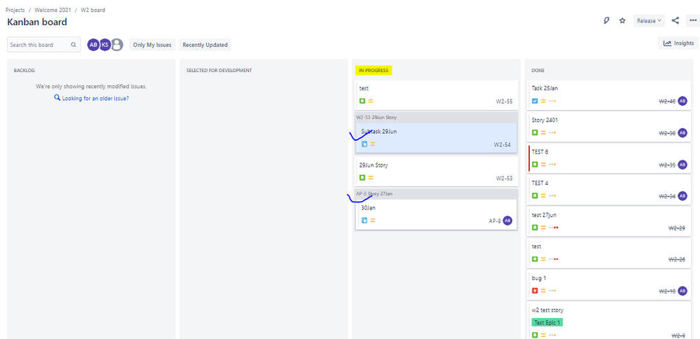

I'm struggling a bit to write this filter down properly and it perhaps could even be done in just one filter, but I haven't found out how yet, so I'm looking for some help.
What I would like to achieve is that on our board it shows all issues (issuetypes and status if you will) but for a certain issue type (Sub-task) I would like to only show the ones that are in progress.
Any ideas on how one could achieve this?

Aron Gombas
January 30, 2023
I haven't tried it, but it should give you the idea:
type != "Sub-task" or (type = "Sub-task" and status = "In progress")
Richard Ramcharan
January 30, 2023
Thanks Aron, This worked out!

John Funk
January 30, 2023
Hi Richard,
Try this: Project = TLMC and (issuetype in (story, task, bug) or (issuetype = Sub-task and status = "In Progress"))
Just change out the issue types that you have in your project.
John Funk
January 30, 2023
Actually Aron's is probably more efficient in case you add issue types. So for a project it would be:
project = ABC and (issuetype != "Sub-task" or (type = "Sub-task" and status = "In progress"))
Richard Ramcharan
January 30, 2023
Thanks for the swift reply, @Aron Gombas his solution worked out :D
