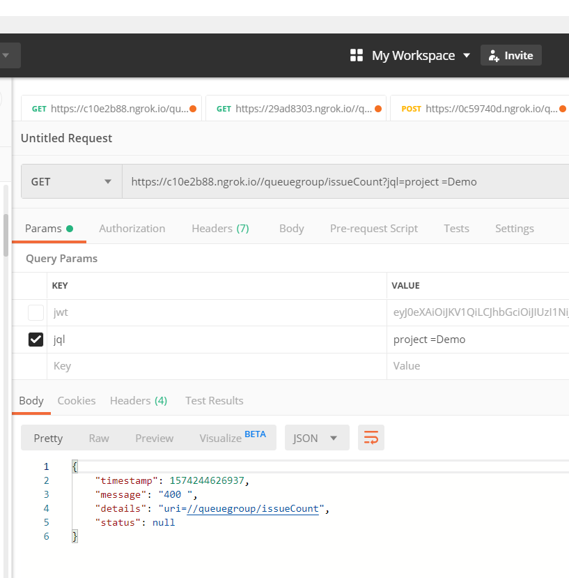

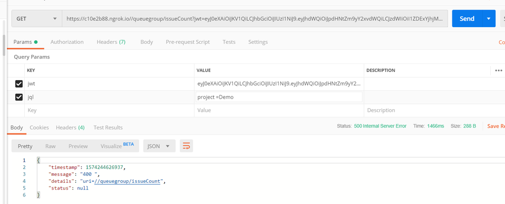

Chakresh Tiwari
November 20, 2019
Chakresh Tiwari
November 20, 2019
Warren
November 20, 2019
Please take a look at my screenshot, because your GET line seems to have many problems :
  • You have 2 sets of //
  • You don't have a valid atlassian URL
  • issueCount isn't a valid API call
What is in the GET box should have this format :
https://companyname.atlassian.net/rest/api/3/apicall?jql=...
where companyname is replaced with the name used in your Jira URL, apicall is replaced by a valid call as per the documentation and a valid jql statement is used
