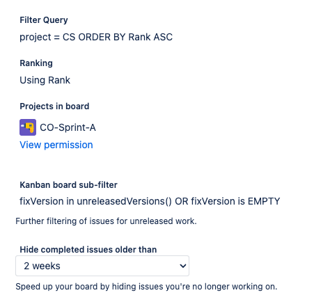

So, to diagnose the problem of issues not appearing in a Kanban board we need to know how the board is configured and some details about issues you think should display but that are not displaying.
What is the filter you are using for your Kanban board?
Do you have the sub-filter specified?
Do you have the Hide Completed option set?
Example:
Do the missing issues meet the criteria of your filter, and not have a Released Version specified in the Fix Version/s field, and are not in a status mapped to the right-most column and having been there for a time longer than that specified in the Hide Completed option?
Can you share with us the mapping of Statuses to Columns for your board?
Do you have any statuses in the Unmapped statuses area of the Columns configuration? Any issue in a status that is in the Unmapped Statuses area will not display in your Board view nor in the Backlog view (if you have the Backlog view enabled).
