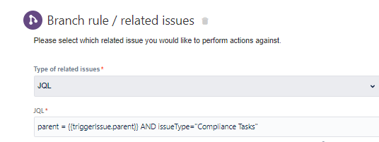

Hey @CoreyM ~ if I understand correctly, you will want a Rule triggered on update of the Sales sub-task, with a JQL Branch Rule similar to what's shown below:

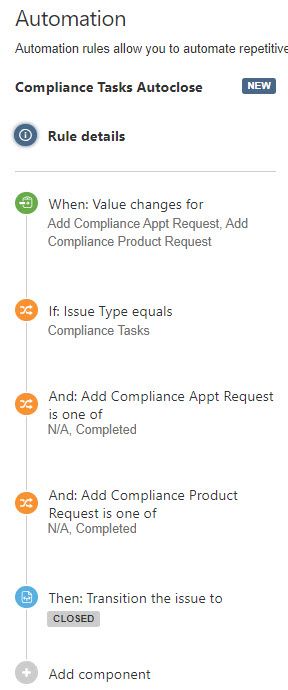

CoreyM
April 24, 2024

Trudy P Claspill
April 24, 2024
I did not see your update with the image of the rule before posting my last reply.
What are the possible values for the fields Add Compliance Appt Request and Add Compliance Product Request?
Under what circumstances are the values in these fields changed?
The way the rule is written it will transition the issue where the fields Add Compliance Appt Request and Add Compliance Product Request have been changed (and contain the specified values). I thought you wanted to close a related issue? Have I misunderstood?
