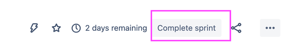

However, when I attempt to complete the sprint from Board 2, the 'Complete Sprint' option is not available; it has a grey background (as seen in the pink box in the screenshot). It only becomes available again when I remove the components from Board 1 from all the issues. This, in turn, leads to the problem of not being able to see the issues in Board 1 anymore.
Furthermore, this problem also arises when an issue is part of two sprints in different boards. For example, one of our hardware developers has an issue in a sprint but requires input from one of our software developers (different team and different board). In addition to adding the hardware component, they also add the software component to link the issue to the software board. In this case, it's not possible to complete the sprint from the software board. I have to review each issue and remove the 'non-fitting' components before I can complete the sprint. Again, this leads to the problem of not being able to see the issue in the hardware board anymore.

Given that the issues are all in one project, then your ability to manage sprints should be the same in both boards.
When you hover over the Complete Sprint button and it is disabled is there any hover help that displays to explain why it is disabled?
Have you confirmed that you have only one sprint selected when you go to use the Complete Sprint button.
The filter dictates what issues will be shown in the board. If you want the issues displayed in both boards, as you indicated in your original post, then the issues have to match the criteria of both filters.
A sprint will show in any Scrum board where the board's filter matches an issue in the sprint. But only the issues in the sprint that match the boards filter will be displayed.
So if you have issue PB23-111 with two Component values assigned, and the Component values assigned means that it matches the filter for both boards, and you assign that issue to a sprint in either board, then that sprint will show in both boards. You will be able to manage the sprint in either board. So, while you see the issue in a sprint in two different boards, it is actually one sprint showing up in two board rather than two separate sprints.
I think we are going to need concrete examples of this problem when it is actually occurring to finish debugging it.
