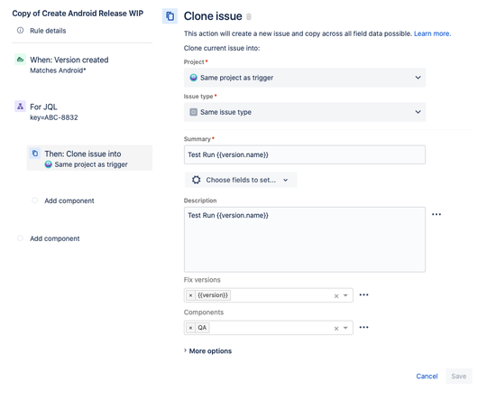

However, when I set a rule to clone that original Test Execution issue it doesn't include the Test issue associations. The rule is triggered by a version created and a set of issues are automatically created. One of them should be the cloned Test Execution issue. I set a condition first to branch rule/related issues and set the issue key equal to the original one followed by a clone action.

Jane from the automation team here. Are you able to please send a screenshot across of your rule so I can have a better look for you? It sounds like you're doing the right things, but without the configuration of your rule, it's hard to tell if there is a misstep somewhere.

thanks very much for getting back to me. Here's a screenshot of the rule.

It looks like we will need further investigations into this. Are you able to raise a support issue at support.atlassian.com with:
  • Details of the audit log - with More details expanded. This will tell us if your rule ran with errors, or if certain conditions have failed, or if it just doesn't perform any actions.
  • This screenshot included - this way, our support engineers will be able to look at how you've configured your rule and may be able to replicate this.
