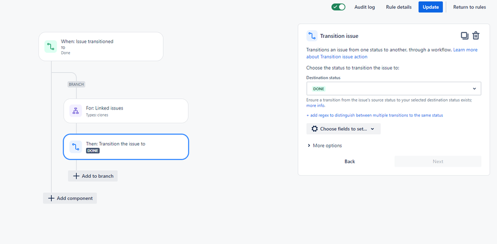

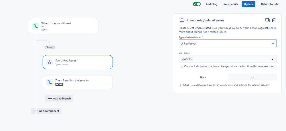

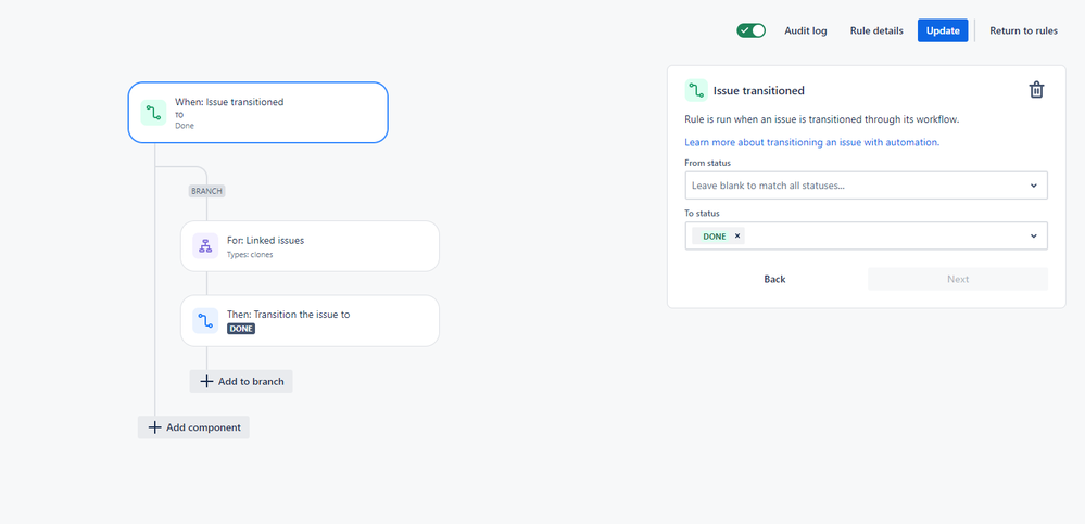

Hi
Yes, you can achieve this by using automation. The trigger will be when an issue transitions to the "Done" column. You can then use a branch to check if it has a linked issue of type "Clone". If it does, you can move that linked issue to the "Done" column.
Automation rule -
