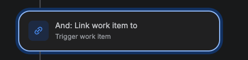

Melissa Mattee Murphy
July 29, 2025
@Trudy P Claspill Is this what you're suggesting? Because this is the final step of my rule.

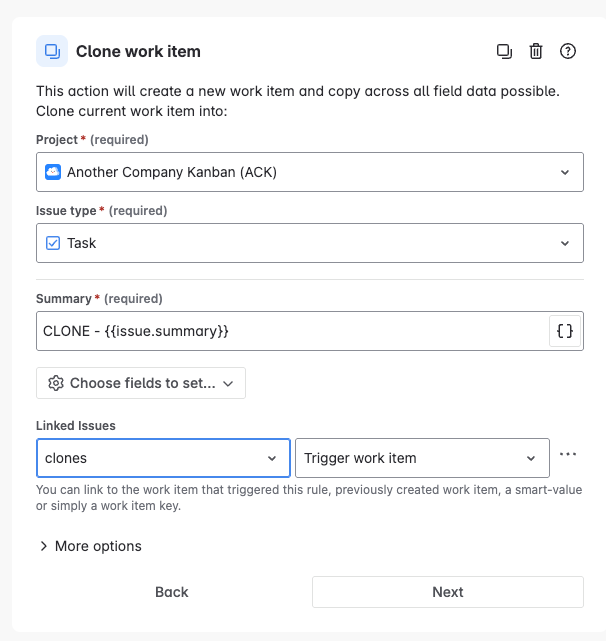

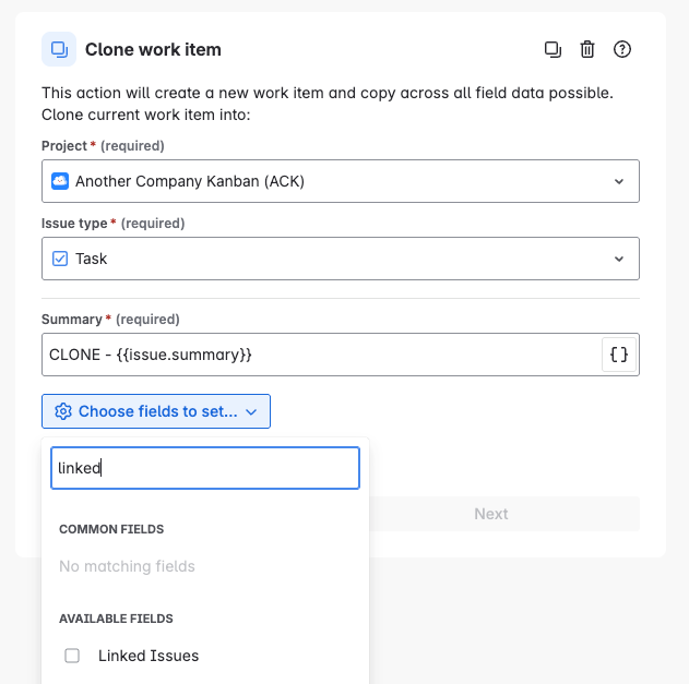

Trudy P Claspill
July 29, 2025
No. You add the link creation directly in the Clone action.
July 29, 2025
@Bill Sheboy
@Trudy P Claspill
I fixed it! I had to switch from "Trigger work item" in the screenshot listed above to "most recently created work item."

Trudy P Claspill
July 29, 2025
That makes sense. When it is a separate action it would be acting against the Trigger issue, unless you had nested it within a branch For Most Recently Created Issue
