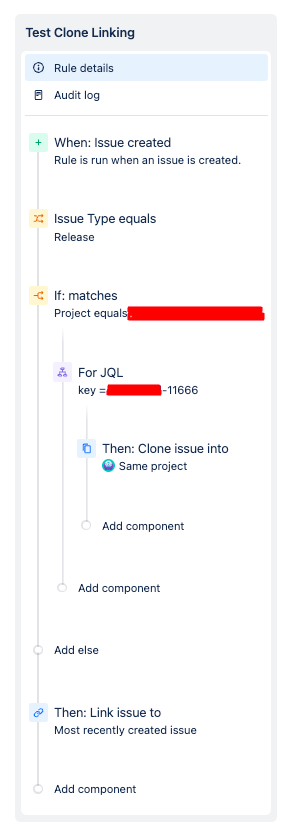

Hi @Matus K
Would you please post images of your rule and of the audit log details showing the execution details?  That may provide context for the community to offer suggestions.
If you have not yet started...I believe what you described is possible as long as you can find your TEST-1 issue based on JQL from data in issue TEST-2.  For example...
  • trigger: issue created (i.e, your TEST-2)
  • action: re-fetch issue
  • branch: on JQL to get your TEST-1 issue
    • action: clone the issue into TEST-3
  • action: link issue (TEST-2) to the most recently created one (TEST-3)

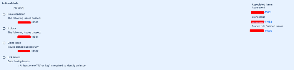

Had similar idea unfortunately your suggestion is resulting in an error:
At least one of "id" or "key" is required to identify an issue.
Tried couple of re-fetches added before the action, but to no avail.
Kind of out of options..

Please post images of your automation rule and the audit log details showing the execution and error.  Those may provide context to help explain this symptom.

Bill Sheboy
February 20, 2023
Ah...branches!
Branches which could be on more-than-one-issue run in parallel and asynchronously.  There is no guarantee of when the branch will finish, up to the very last step of a rule.
So the cause of that error is the Link action runs before the issue is created.
A possible work-around is to add a Re-fetch action before you try to link.  That will slow down the rule, possibly giving enough time for the create before the link action.
If that does not work, we will need to rethink the problem to find a new solution.

Bill Sheboy
February 20, 2023
Nope...it appears the Link action is so much faster than the clone that the re-fetch will not help.
Let's do this a different way, moving the link closer to the clone:
Matus K
February 20, 2023
Yep, completely forgot about advanced formatting. Thank you, that should do the trick, Bill.  :)
