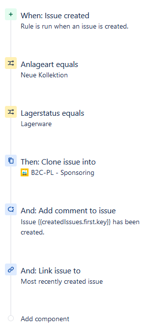

Hi,
I try to clone an issue if certain requirements are matched:

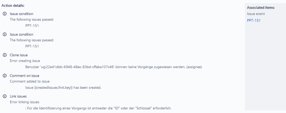

But sadly i get the following error message:
What could be the problem here?
I already checked the atlassian-addons-project-acces permission and it should be correct.
Greetings
Simon
Hi Simon,
I don’t know the language for the error but it seems to be complaining about the assignee. Either the assignee is inactive or that person is not able to be assigned issues in the new project. I would check there first.
Hi John,
Do you mean that the person how creates the issue in the main project should also have the create-issue and the browse-project permission in the targeted project (clone)?
Greetings
Simon
Hi John,
Thank you very much!
Now I found the error.
Greetings
Simon
Thank you!
The problem was, that in the original project the issue was assigned automatically to a specific user. But this is also the same step where the requirement of the issue-cloning-step was updated and the issue got cloned. This user wasn´t a assignable user in the target project.
