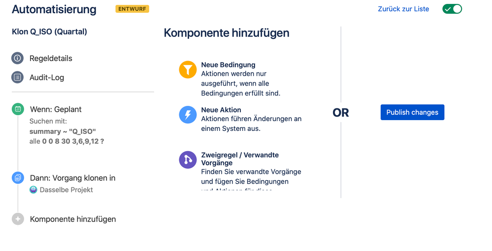

That's my actual automation:
Hi @Marius
See the answer of Commodore, you need to add this value "{{createdIssue.key}} to the parent issue.
Sorry that will not resolve my problem.

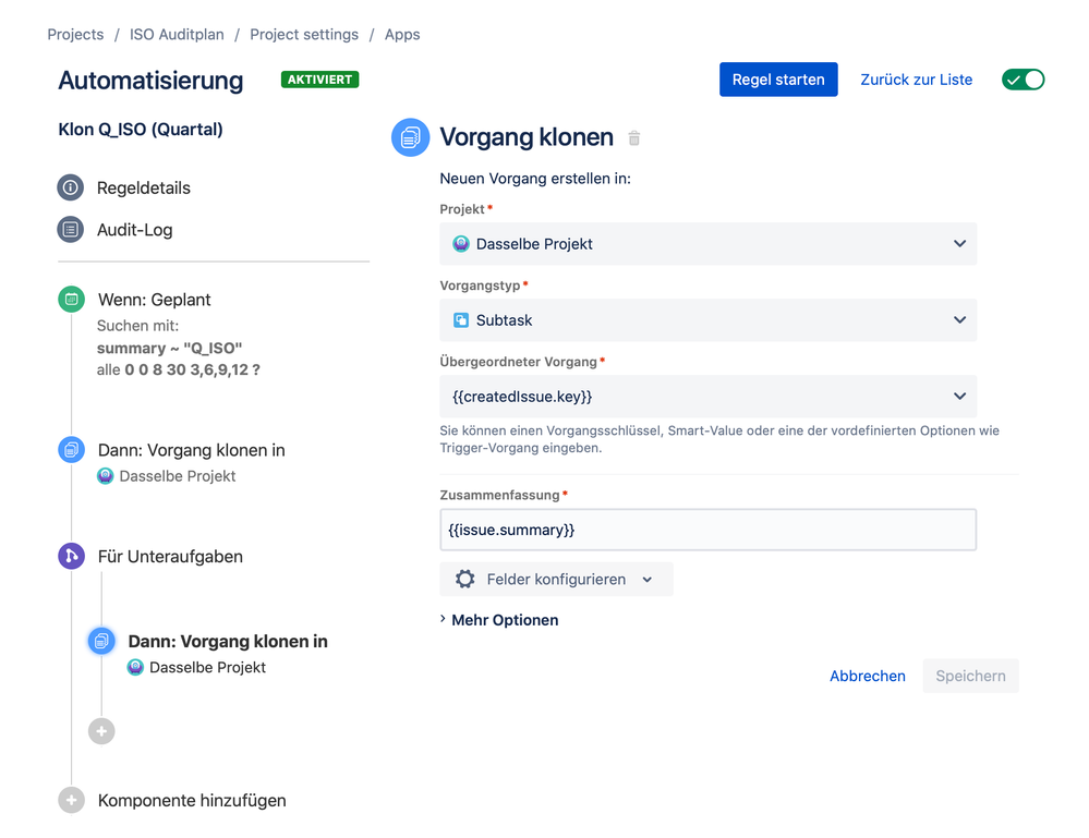

I don't have a manually trigger. I have a planned rule, please see my screenshot.
But i take a look on your Link and the picture in your link is telling me, that I have to write "{{createdIssue.key}}" to the parent Issue field. But in the "Parent Issue" field i have a drop down to choose "Aktueller Vorgang" or "Triggervorgang".

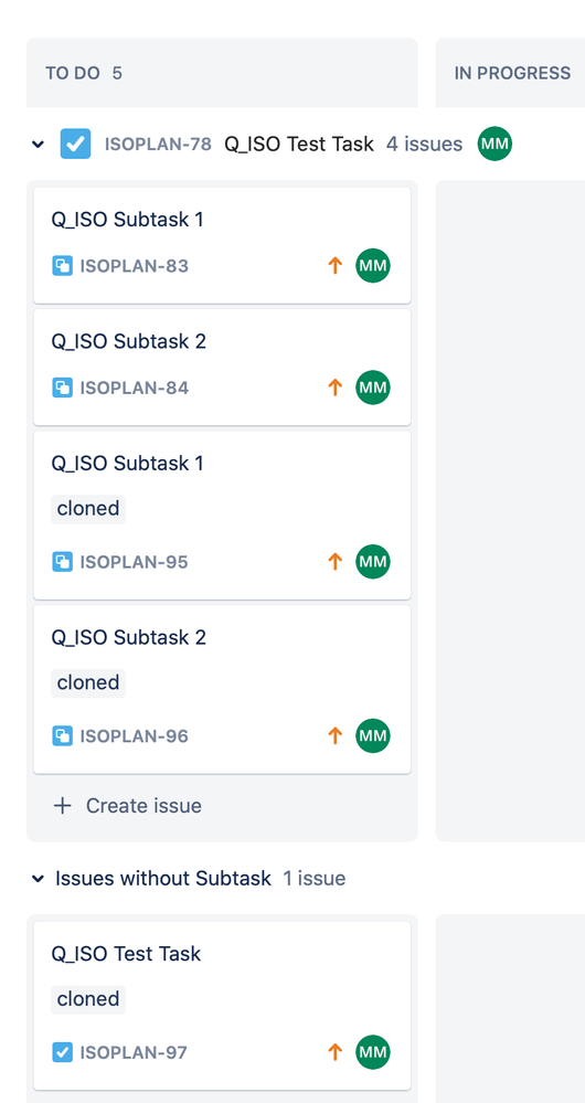

Initial Situation:
Task 1 incl. Subtask 1 and Subtask 2
New Situation after running the rule:
Task 1 incl. Subtask 1 and Subtask 2 AND cloned Subtask 1 and cloned Subtask 2
Cloned Task 1

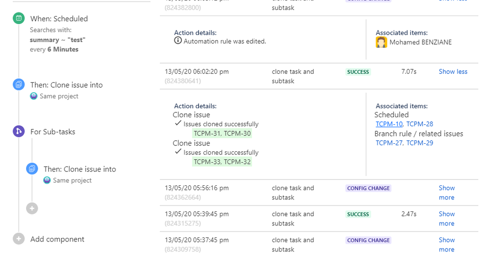

Weird, it working good in my instance. If the first task have 2 subtask then the new task have only two subtask too
Can you share your automation pls
Of course. Here you see my Automation and in the second picture you see the result after i runned the automation.
My Automation is unfortunately in German. I switched the language in Jira to English but the Automation part is always in German. I hope you can understand it anyway.
here my automation, it works fine. I think is the same as your (sorry i can't read german :) )

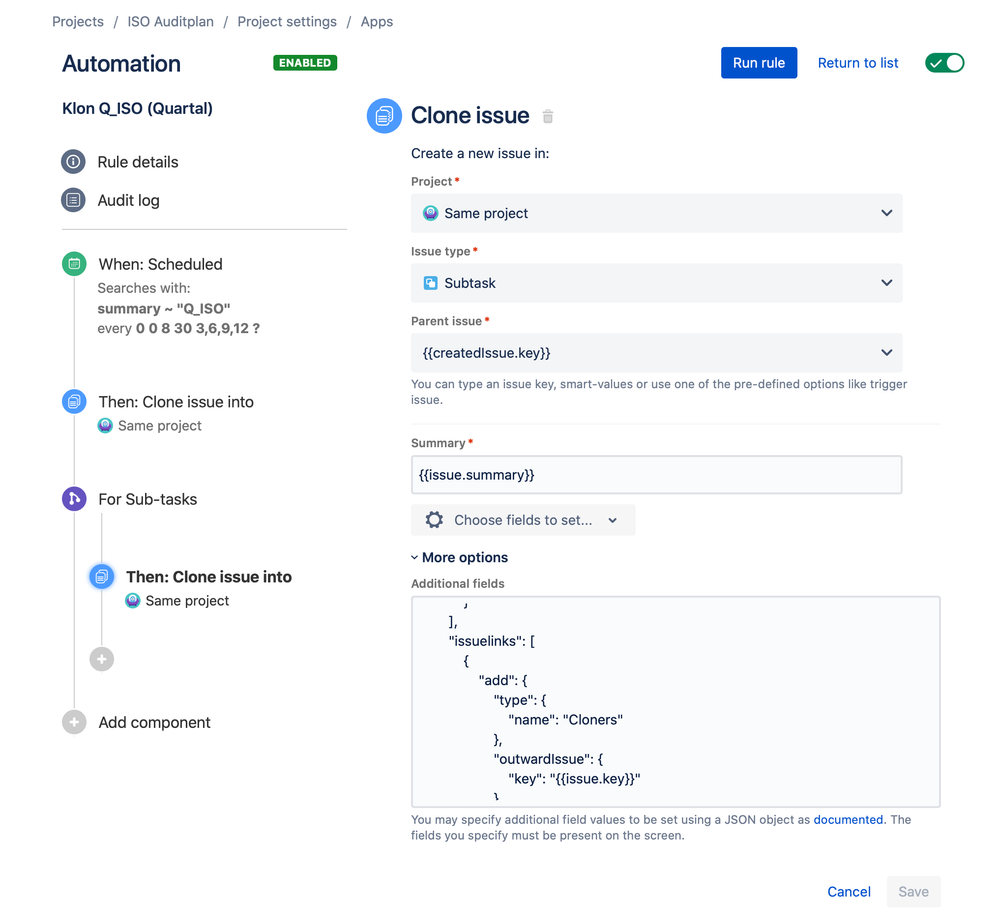

thank you for your Screenshot. Now here's my automation in english.

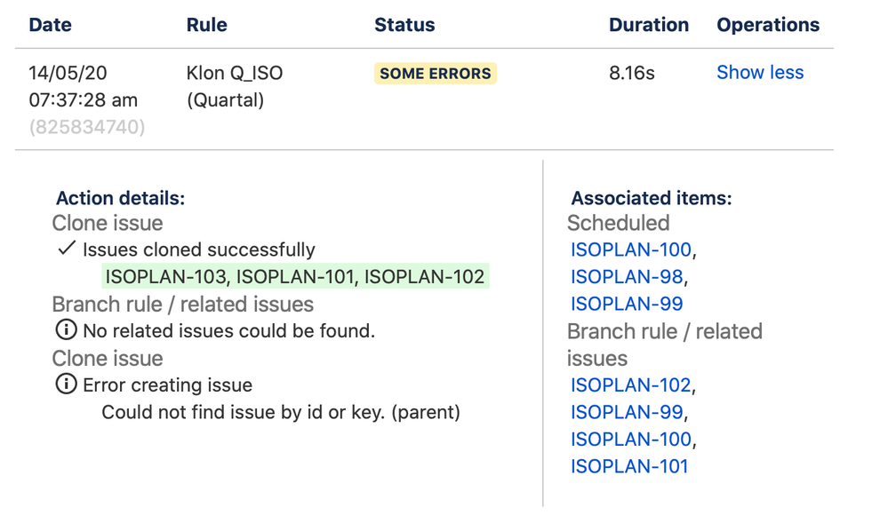

When I run the rule, there is an Error in the Logfile (see second picture).
The result is the same as yesterday: It clones all the Issues and Subtasks but did not add the cloned subtasks to the cloned task. It adds the cloned subtask to the origin task.
Maybe you can see a wrong setting?
//edit: I figured out: When i changed the "When: Scheduled" to "manually Triggered" then the rule runs correct.
So is there a wrong setting on my "When: Scheduled"?
