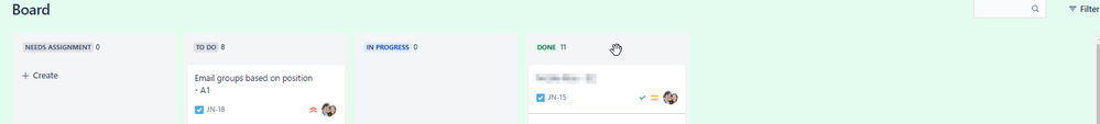

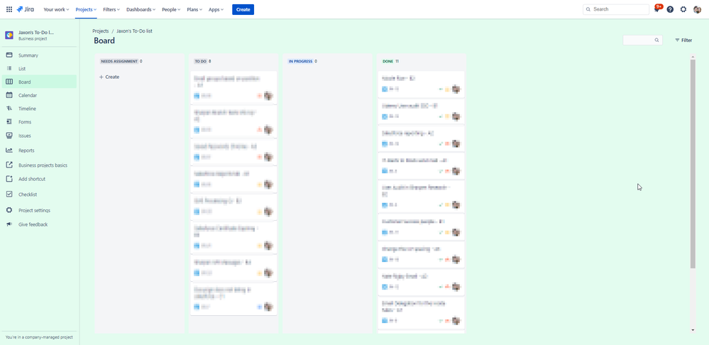

Jaxon Nix
December 13, 2021
I do not have that option. I only have a gear icon for the project settings and a filter button that I can filter based on who has the items listed.

Jack Brickey
December 13, 2021
what type of project? CMP or TMP. If CMP then is it JWM or JSW? I need a more complete view of the project screen. I would think old done issues would age off.
Jaxon Nix
December 13, 2021
It looks like it is a CMP. I am not familiar with what JWM and JSW are. Sorry I am a little new to the platform. I blurred the cards as there is some non-shareable information on them. Does this help?

Kristján Geir Mathiesen
December 13, 2021
Hi @Jaxon Nix
JWM is Jira Work Management project template (which this project is because the items "Calendar", "Timeline", and "Forms" are on the left.
JSM is Jira Service Management  project template.
I don't see a way to hide older issues either. The "Board" is hard coded in the left panel so I assume the filter behind it is the whole project (i.e. project = abc).
