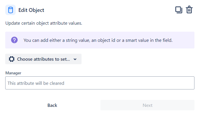

I noticed that if you use the “Edit Object” action in an Automation to set fields, that works great but if you are trying to clear a field you can into an Error message (Automation Rule failed).
The scenario is that you use the “Edit Object” action and you want to clear an attribute.   So, you pick that attribute from the dropdown list and then instead of putting in a value, you leave it blank.   You can see that the field is blank, it says “the attribute will be cleared”, and so that is promising.
It works great when the attribute is already set to a value in the object.   But when the attribute is already empty you will see messages in the rule log like “Objects were skipped” and “Error updating Object(s)” and overall Automation Rule will also fail.
I think the behavior should be that it not error.
The workaround available for me is that I check the value of the existing attribute in JSM Assets and only then “set” (clear) the value.  Since Automation does not allow IF blocks within the “For AQL” I don’t believe you will be able to do this for multiple attributes.
I had tried setting an empty expression e.g. {{}} etc. and that did not seem to work.
Let me know your thoughts if you disagree that this is a Bug/Feature, or if you found this useful.
