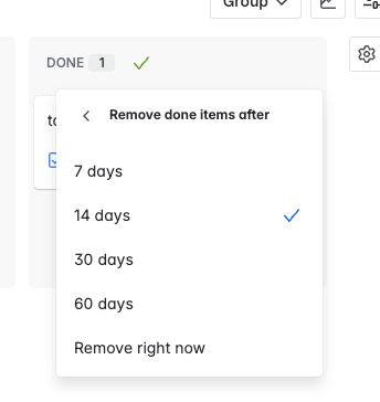

Hello everyone,
I've a follow up question on the above user-flow
What happens if i click "Remove right now" and how can i see the removed items?
Thank you!
Trudy P Claspill
October 20, 2025
Hello @Sathya Krishnamurthy
The items remain in the project. You can find them on the All Work Items tab, and through searches
The feature is only for reducing what is displayed in the board view.

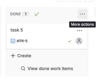

Hello @Reva Darlius
If you hover your pointer on the upper right corner of the Done column do you see a button with 3 dots appear? (not the 3-dots button in the card).

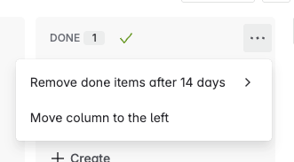

When I click that More Actions button I see options like this:
If I click the Remove done items after... option I see more options like this.
If I click the Remove right now option, that clears the issues from the Done column.
