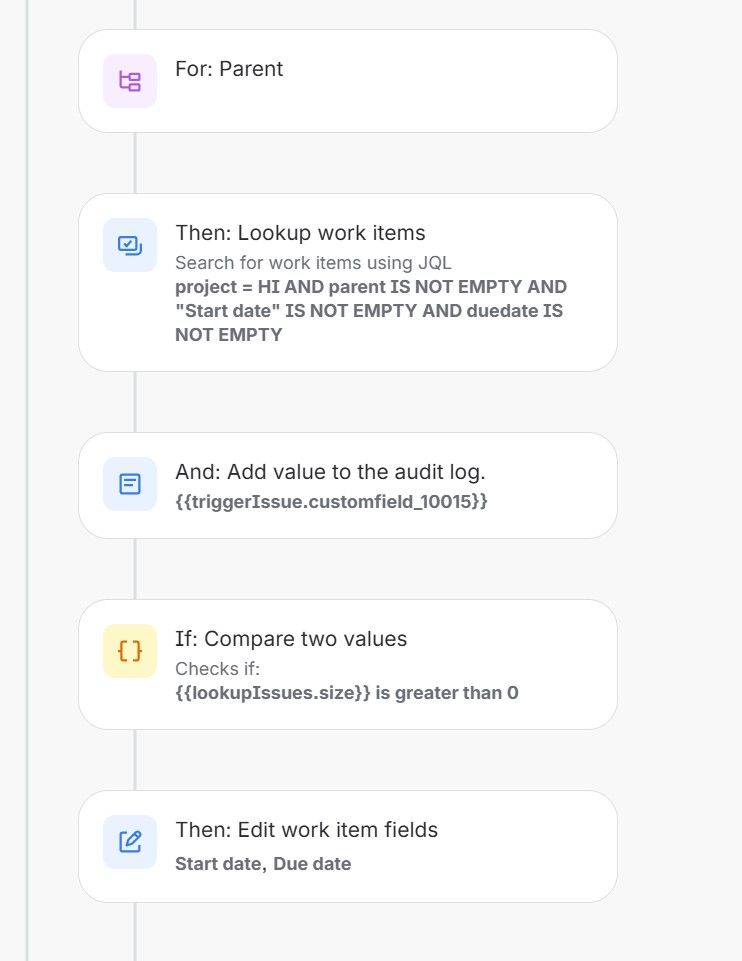

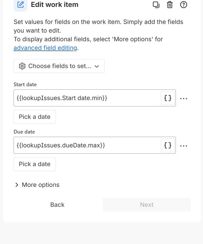

I am running into an issue with automation to have the child min and max start and due dates top roll up to the parent start and due date. It seems to be pulling the due date no problem but it's not pulling the start date. Screenshot 2026-02-10 112514.jpgScreenshot 2026-02-10 113037.jpg
2 votes
Bill Sheboy
February 10, 2026
Hi @ckopanon
Start Date is one of the date fields which appears as text to automation rules...similar to other roadmap fields.  The workaround for your scenario is to convert the value with the toDate function  before attempting to use the min function, and then convert back to the necessary date format as text.
For example:
{{lookupIssues.Start date.toDate.min.jiraDate}}
Please see updates below...

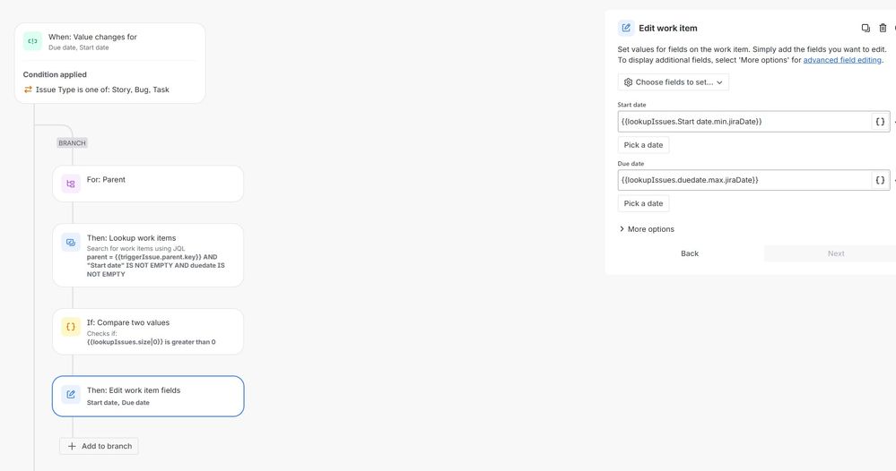

Bill Sheboy
February 12, 2026
Hi @ckopanon
Please review the earlier posts in this thread where I describe your Lookup Work Item action's JQL does not reference the parent...and thus you may be looking at the wrong work items.
Within the branch, if you wanted the lookup to use the parent, the rule would look like this:
  • trigger: field value changed, for Start Date or Due Date
  • field values condition: issue type is one of Story, Bug, Task
  • branch: to parent
    • action: Lookup Work Items, with JQL of
      • parent = {{triggerIssue.parent.key}} AND "Start date" IS NOT EMPTY AND duedate IS NOT EMPTY
    • smart values condition:
      • first value: {{lookupIssues.size|0}}
      • condition: greater than
      • second value: 0
    • action: edit work item, setting the fields with:
      • Start date: {{lookupIssues.Start date.min.jiraDate}}
      • Due date: {{lookupIssues.duedate.max.jiraDate}}
Thanks,
Bill
ckopanon
February 12, 2026
hello,
i set this up exactly how you have it listed and unfortunately, no dice. This time though its not pulling the due date either.

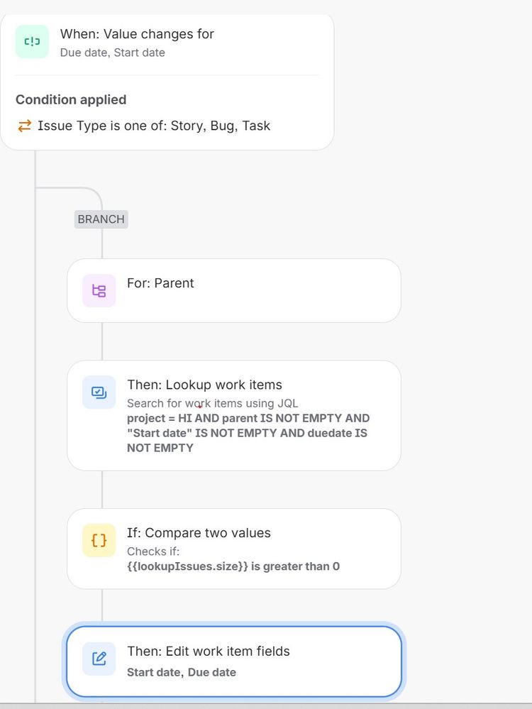

ckopanon
February 12, 2026
John Funk
February 12, 2026
So which field did you change on the trigger to get it to fire?
And neither field got updated?
You might want to log the lookupIssues.size to see what the value is.

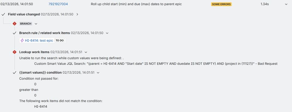

Bill Sheboy
February 12, 2026
Please post the audit log details showing the rule execution after your changes.  This will confirm which work items the rule attempted to process.
And just to confirm, are all of the work items involve in a single space / project: the parent and the children?

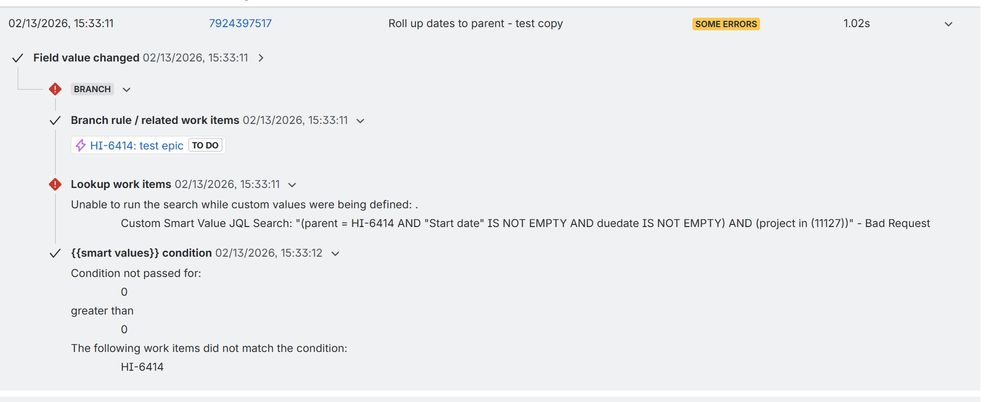

ckopanon
February 13, 2026
John, I changed both the due and start date in the story and it did not roll up to the Epic.
Bill, yes, all of the work items are  from 1 space.
Here is the audit log. I updated the start and due dates in the child story whose parent is the epic listed.
Bill Sheboy
February 13, 2026
Thanks for that log information, and it seems to show problem with the lookup itself.

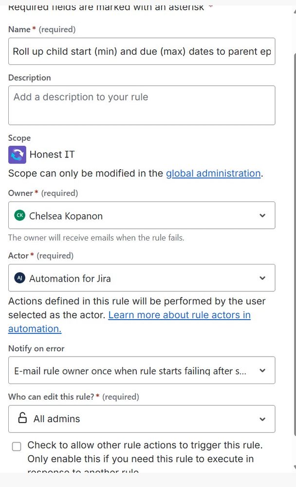

Please post an image of the rule details at the top, showing the scope, actor, etc. as those may identify scoping, permissions, or configuration problems.
And, I wonder if the rule has become "glitched" by too many edits.  (This can happen when the saved rule JSON / data gets corrupted.)  The way to test for that is:
  • disable this rule
  • re-create it from scratch to test again
  • if the new rule works, delete the old one
Like John Funk likes this
ckopanon
February 13, 2026
hi bill, here is a screenshot of the rule details. I also disabled the rule, created it again from scratch, tested again, and still no luck. Including a screenshot of the log as well.

Bill Sheboy
February 13, 2026
Hi @ckopanon
Thanks for those screen images!  Here is my current hypothesis...
Your original rule had incorrect JQL in the Lookup Work Items action to find the sibling children of the parent, which lead to the wrong items being selected for updating the fields.  Trudy, John, and I helped to address that and other rule improvements, however...
Since that time, yesterday an Atlassian defect started happening with increased errors rates for API endpoints, and that may be manifesting as the problems with the lookup action trying to read the work items.  Thus, we may be stuck on diagnosing further until that defect is scheduled for fix this weekend or Monday.  You may subscribe to that incident by email to see any progress.
So you have a couple of options:
  1. Wait until Monday and then re-test your rule
  2. Work with your Jira Product Admin to contact Atlassian Support now to take a look, asking them to review the rule and their logs.  As their response time for your license level and the likely incident severity may be several days...
I recommend trying both: work with your admin to submit the ticket, and while you are waiting, test again on Monday, 16 February after the API defect is planned for a resolution.

It is possible that there is more than one field in your system named "Start date" and the rule is not getting the correct one within the Edit Work Item action. An alternative method to set the value would be to use the custom field id instead of the custom field name as the reference; i.e.
{{lookupIssues.customfield_11111.min}}
You would need to find the correct ID for that specific "Start date" field. This document explains how that can be done.
https://support.atlassian.com/cloud-automation/docs/find-the-smart-value-for-a-field/

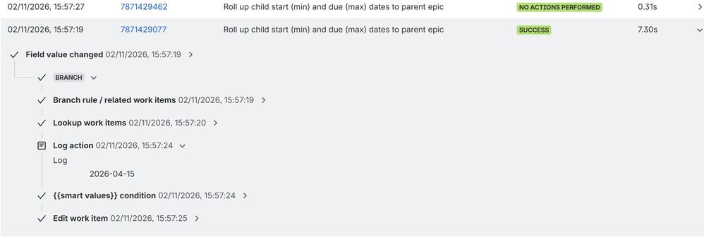

ckopanon
February 11, 2026
yes, i can confirm i have the case correct.
i added the branch and it looks like the log is only showing the start date for the child work item
Trudy P Claspill
February 11, 2026
Can you show us images of the modified rule and the details that generated in the rule execution log?
ckopanon
February 11, 2026
Let me know if i have this wrong:
John Funk
February 12, 2026
Hey Chelsea - I hope all is well with you.
Yes, the log is only showing the child start date because you are using triggerIssue.xxx - the trigger issue is the child issue.

John Funk
February 12, 2026
I don't see anywhere where you are matching the parent with the parent of the parent from the lookup issues. Take a look at Bill's last post for that.

Trudy P Claspill
February 12, 2026
Hello @ckopanon
When sharing the log please click on all the ">" characters to the right of the message to expand/show all the details related to each of those sections.
Additionally, the Log action you added was not quite what I meant. My intention was to have the field printed for each item found by the Lookup Work Items. Since you can't nest one branch within another you would need to create a separate branch to iterate over the same items found by your Lookup action.
But what has also occurred to me is that the JQL in your Lookup is not correct. I see that @Bill Sheboy provided an example of the correct JQL to use.
Can you add to the response thread with Bill the details of the execution log for that version of the rule. And as I mentioned at the beginning of this reply, make sure that you expand all sections so we can see all the details.
In that scenario where you did not get the Due date updated either, I suspect that may be due to your JQL statement. It will return only child items where both Start date and Due date are filled in. I suspect that when you tried to use that version of the rule you may have gotten no items returned by the JQL due to none of the items having both fields filled in.
Where you were getting values before you were using a JQL that would return the same (items with both fields filled in) but you did not have the criteria for Parent set correctly. Your original JQL would've been returning items that did not have the same parent as the trigger item.
