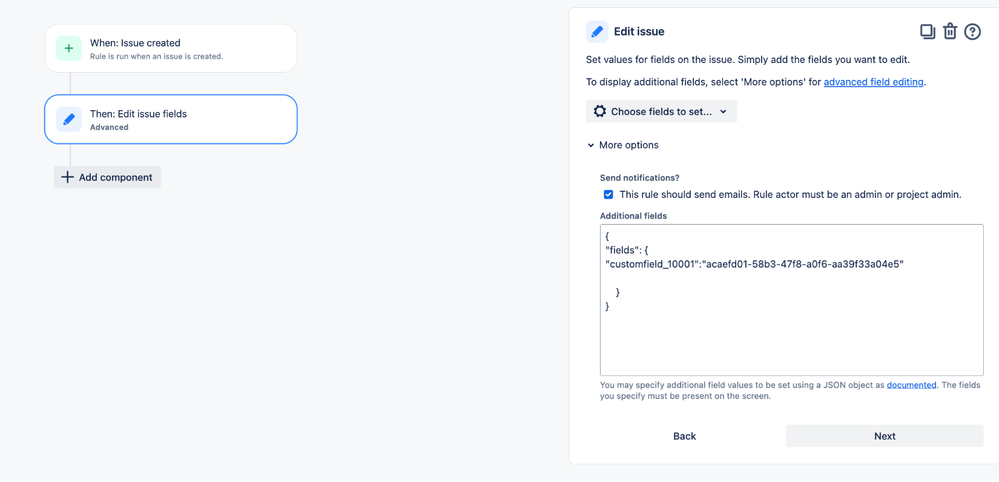

Prachi Bolar
June 29, 2025
hello,
Welcome to Community :)
You. can do it via automation
Requirements :
Team Field : https://abc.atlassian.net/secure/admin/ConfigureCustomField!default.jspa?*customFieldId=ID*
Team Name: TEST ABC
Team Id : JQL: "Team[Team]" = "TEAMID"
Code to be used in automation
"fields": {
"customfield_ID":"TEAMID"
Thank YOu,
prachi

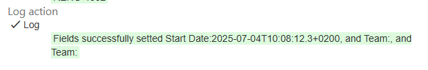

Dejan Velevski
July 4, 2025
Hi @Dilip
I tried that already and it returns nothing :( i.e. I don't see it in the Audit Logs. For example, I have added the Date, i.e. {{now}} also in the logs:
Fields successfully setted Start Date:{{now}}, and Team:{{issue.Team.id}}, and Team: {{issue.customfield_10201}}, the Audit Logs are:
where in "Edit issue" I have:
"fields": {
"Start Date": "{{now}}",
"customfield_10201": "{{issue.Team.id}}"
