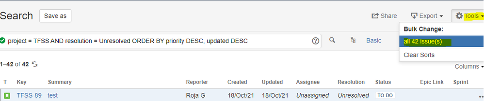

This i tried earlier. But , now my question is i need to change the RESOLUTION field value for the existing issues ( Around 750+ issues ) in one of my TEST project.
How do i achieve this with the help of BULK Permission please ?

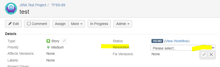

Though the RESOLUTION Field (which is a System Field) is present on the screen, i couldn't see the filed when doing the BULK operation.

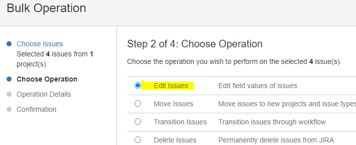

Yes, using the same option. I can edit the field directly on the screen. But not the bulk operation. Attached screenshots for your reference.

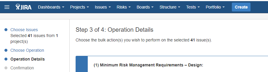

When i choose EDIT ISSUE operation then it will take me into the Operation Details section here we will get the list of fields right there i am trying to search for RESOLUTION field.

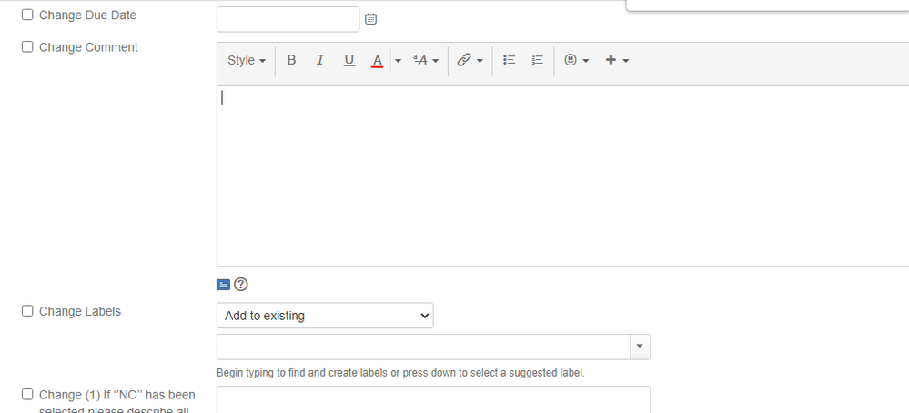

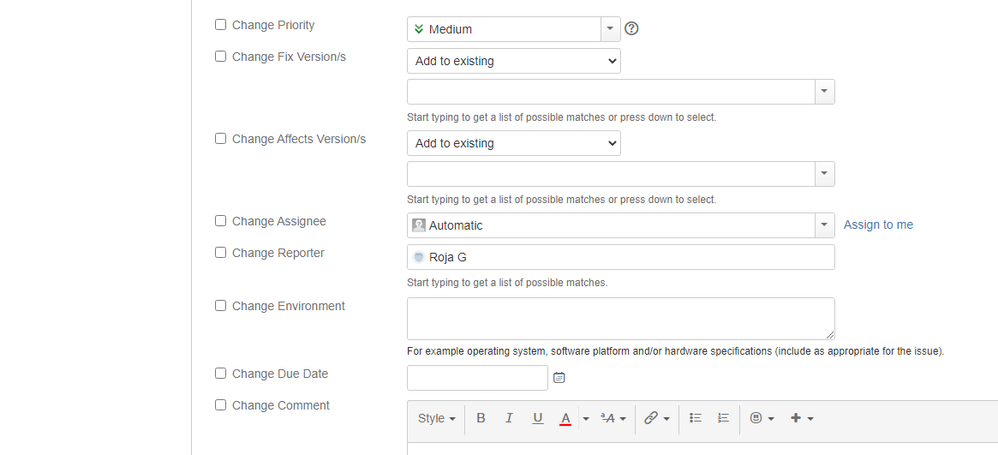

Ok, so "Change resolution" is not appearing anywhere in that list?  I'd expect it to be a bit below "change comment" - the first batch of fields you see are "system" fields, so it usually falls in there.  The second section is an alphabetically sorted list of custom fields.

 "Change resolution" is not appearing anywhere in that list? - Yes, not there.
I'd expect it to be a bit below "change comment"  - Not there.
