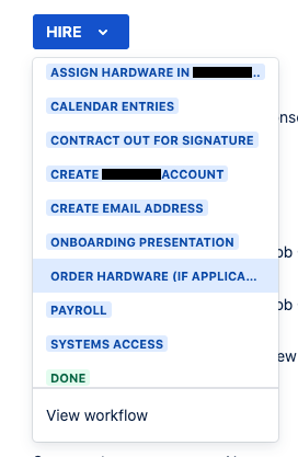

Hi All,
I would like to change the order of workflow buttons displayed in our Jira Cloud project. I created the workflow multiple times as I though it has to do with the order in which they are created, however, this doesn't seem to do anything.

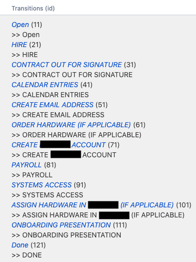

When viewing the workflow in text format rather than diagram, I realised that each transition has a Transitions (Id) and the order of the workflow is correct there. Basically the diagram and the text version are showing me the correct order of the workflow, but when I'm in the ticket clicking on the status dropdown, it's all jumbled up.
Any ideas?

Hi @Rob C ,
You can rearrange workflow transition buttons using a "opsbar-sequence" workflow property. There is one good video on you tube on how to do it
https://www.youtube.com/watch?v=TKrzm6PrY7w
To rearrange workflow buttons, you can add the property key opsbar-sequence to each workflow transition with a value.

Hi Niranjan,
Thanks for getting back to me. I swear I tried it and it didn't work. But now it does work. This is awesome. Thanks so much.
