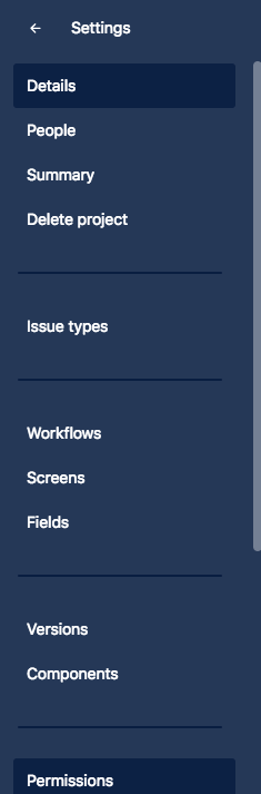

I mistakenly created a project that I now want to be a Scrum project. I read the boards which said the template shouldn't matter.

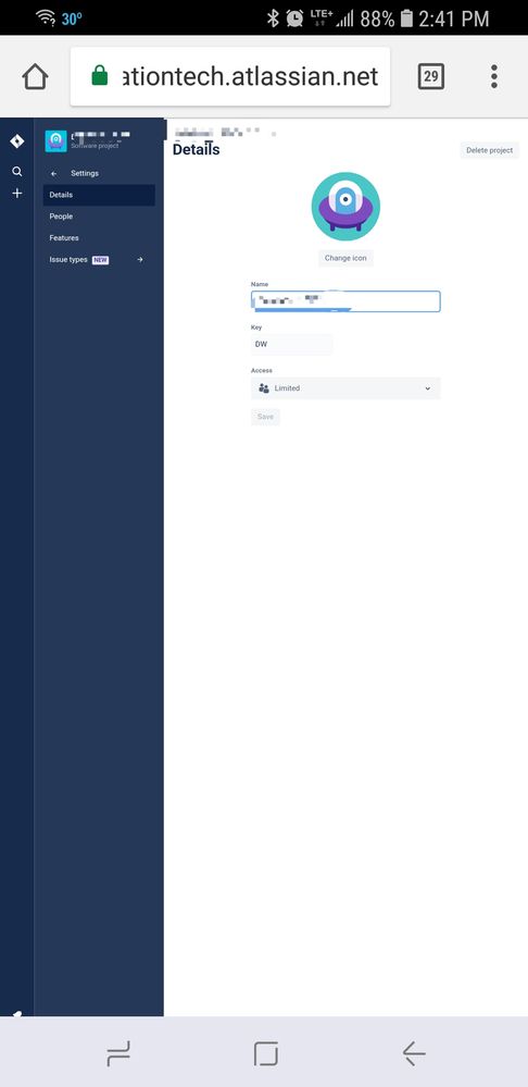

However, to this Old Project, I cannot add Story Points. I have tried Enabling Global Context in the Custom Fields, but I cannot find my project there. I also have limited Project Settings. Please see attached Image 1 and Image 2. DW Test is not the name of the Old Project.Image 1.png

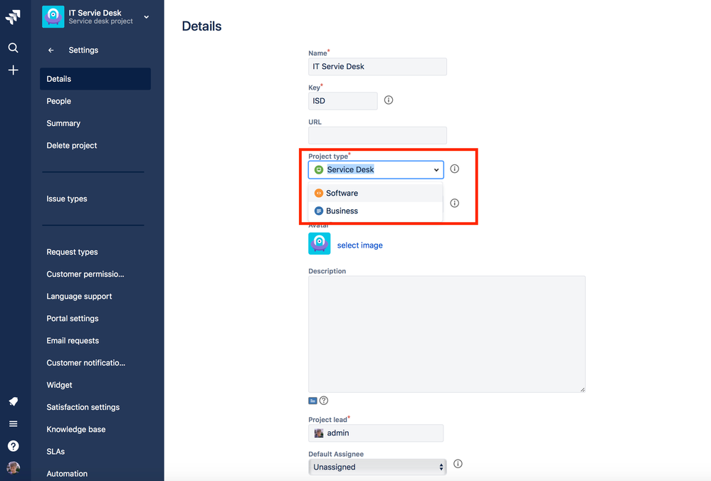

I have created a Test Project called (DW Test), which I selected to be a Scrum project. With this test, I can specifically select it to be enabled in Custom Fields. See Image 1. I also have more Project Settings for DW Test. Please see Image 3.Image 3.png
How do I turn my Old Project to have the same settings as my Test Project? I have looked everywhere!

What was the template for the first project? It looks like an independent project, which is created by a user who does not have Jira Administration permissions.
Templates could be changed between Software, Service Desk and Business. This option is available in the Details tab.
Fiona Yeung
July 4, 2018
Thank you so much for trying to help.
I am the admin, and I was the one who created the project. I don't remember which template I chose though
I did click into the project details, but the options are very limited. Please see screenshot.

You can not change an independent project to another project. You can create a new project and move issues from the old project to the new one.

Looking at the screenshot it seems that the project you have created is an independent project with the Agility template. As Alexey mentioned above, you cannot change an independent project to another template.
Independent projects with Agility template are a new feature in Jira Software that is still in beta testing. The main difference is that you don't have to be an administrator to create a project and the overall structure of the project is much simplified.
