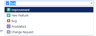

Now working on the "task" the issue type needs to change to an "epic".

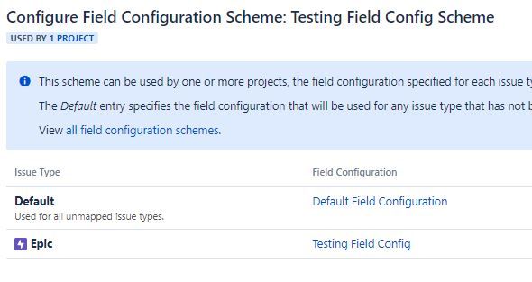

However, when changed to "epic" there needs to be a field that is now mandatory to fill out. "Epic" is associated with a different field configuration where that field is set as required.
The only thing is that I cannot change the "task" to an "epic" when editing the issue - I assume that is because of the two different field configurations?

It is the different configuration.
You can use the "move" option to change the issue type, it will take you through a process of checking for data loss and filling in required fields.

Yes, the "move" option is complex.  It has to be.
By changing an issue to a type with a different configuration, you are effectively making a structural change, and that process may need to ask for new data or warn you that data is going to be deleted.
In the case of converting Story-level issues to Epics, or vice versa, you cannot avoid using move - Epics have a mandatory name field, that can't be put on other issue types, and Epics can not have Epic Links.  The move process will demand a name when going from issue to Epic
To make a field mandatory, I would use field configurations - have one for non-epics, and a second for Epics.  In the Epic one, flag your field as mandatory.  This would force people using "move" to change a story to an Epic to enter something as the type changes, you don't need a Behaviour at all.
