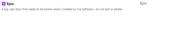

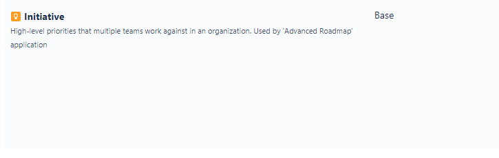

Could you please send a screenshot of Issues -> Issue types and type Initiative in the search field, so we can see it's type.

Sean Grant
February 10, 2023

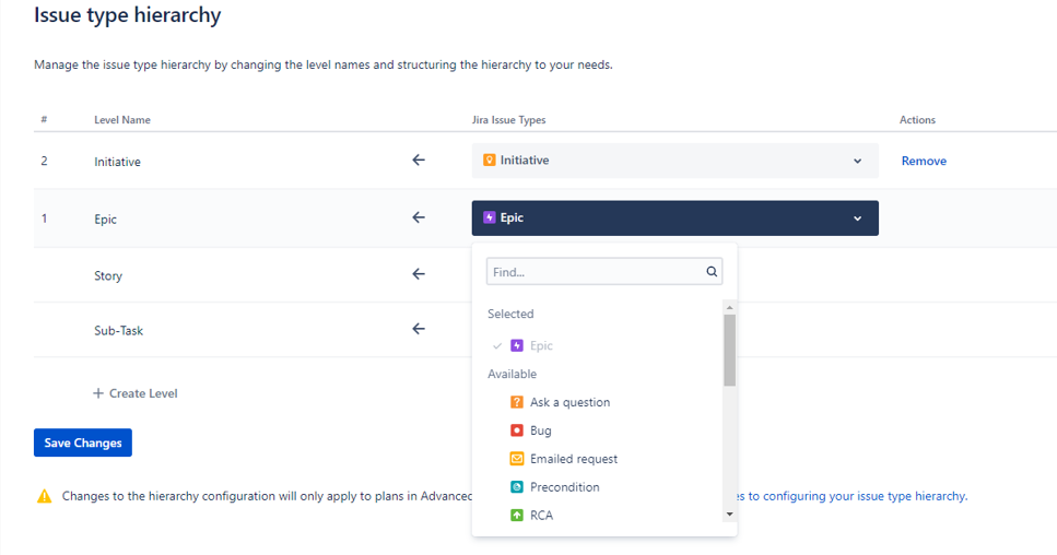

Magdalena Zhisheva
February 10, 2023
Hi @Sean Grant ,
Epic level can't be changed.
In this hierarchy level you may just add levels above epic and add them as a parent to the epic using parent link field.
And actually, the "Add a child issue" button won't appear, but you will be able to link issues above epic with Parent Link field, i.e.
The Stories, bugs, Task etc. have epic link and you put their parent there.
The epics should have parent link and you can put their Parent initiative there.
Hope it makes sense!
Sean Grant
February 13, 2023
I have been using the Parent Link but why would the "Add a child issue" not be available? is it because the Type is Base and only Epic get that option?
Magdalena Zhisheva
February 14, 2023
Hi @Sean Grant ,
 "is it because the Type is Base and only Epic get that option?" Yes, that's the reason :)
