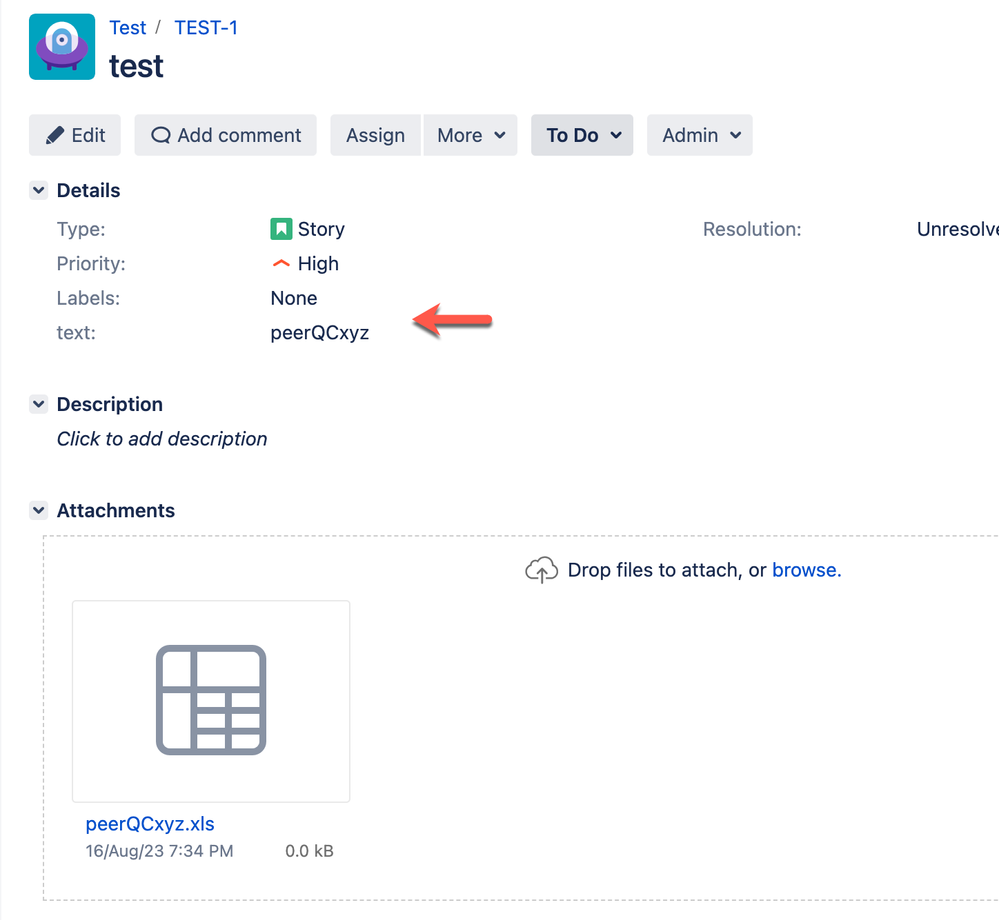

Hi Team,
Is this possible? If an attachment is attached with a certain text in the attachment name update a custom text field with the attachment name?
Example: if a change request gets an attachment called peerQCxyz.xls, look for "peerQC" and set the value of a text field to peerQCxyz. If there is peerQCyz.xsl after have initial value set, that initial value can be overwritten and have the text field value peerQCyz.
Is this feasible?

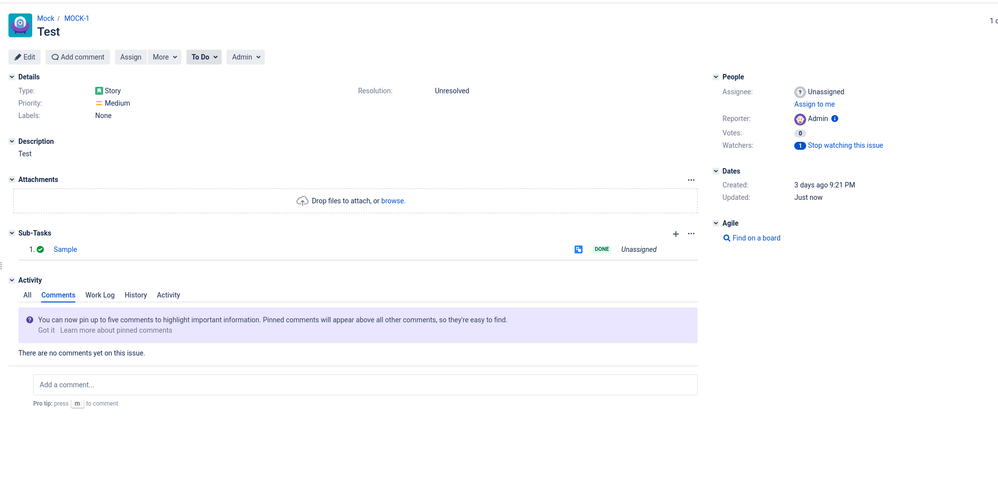

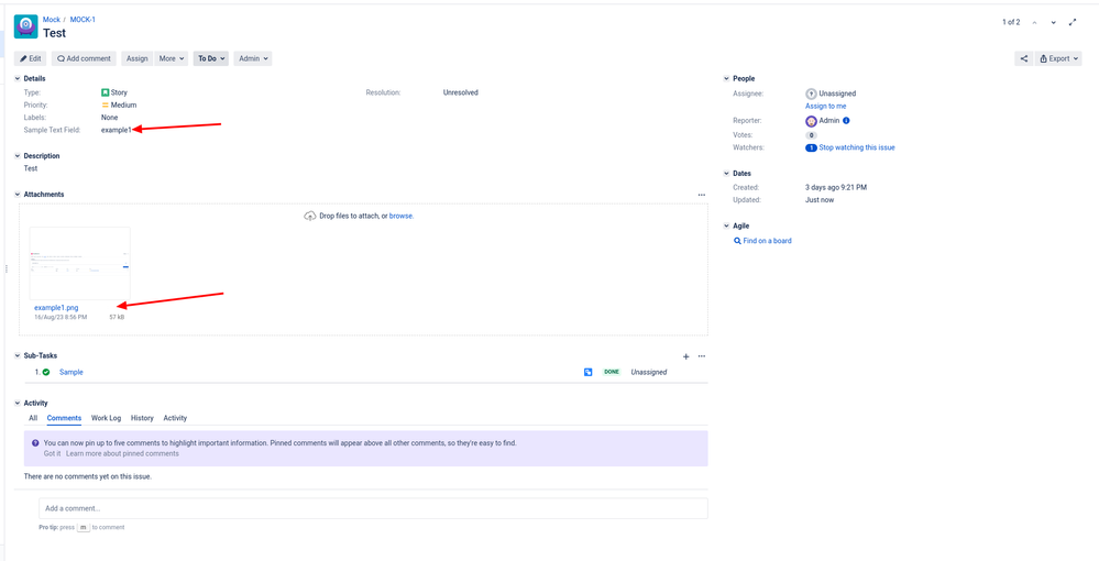

Below is a screenshot of the Listener Configuration:-
Below are a couple of test screenshots for your reference:-
1. First, I created a sample Issue.

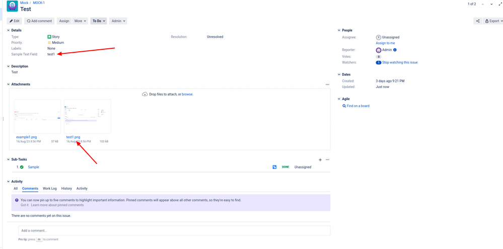

3. Once the Attachment is added, as expected, the Sample Text Field is updated with the attachment's file name.
4. Next, I tried to add another attachment, and as expected, the Sample Text Field is also updated as expected.
Note: once you have added the attachment, please ensure to refresh your browser to see the update take place.
I hope this helps to solve your question. :-)

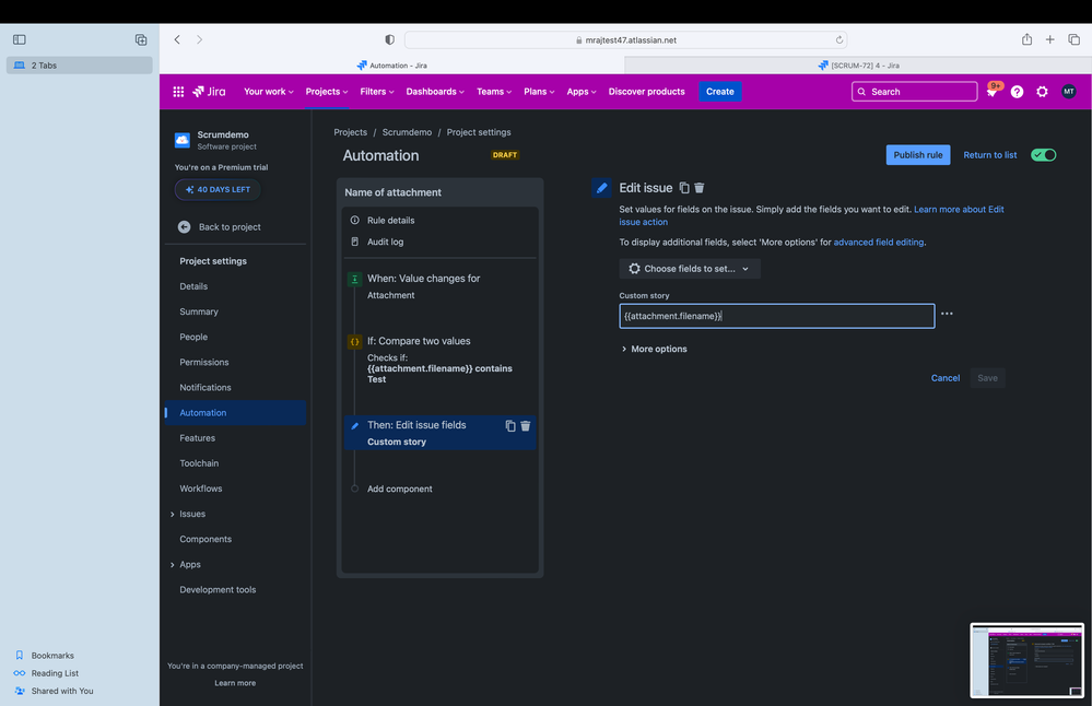

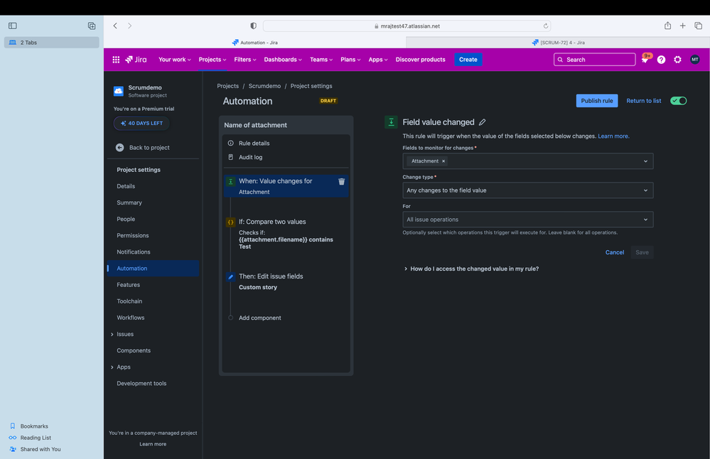

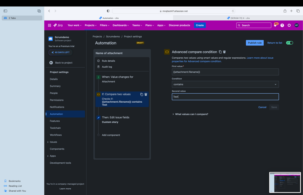

Hello, Good day. You can try the automation rule to check the file name and edit the custom field.
Screenshot 2023-08-15 at 10.41.15 AM.pngScreenshot 2023-08-15 at 10.41.19 AM.pngScreenshot 2023-08-15 at 10.41.22 AM.png

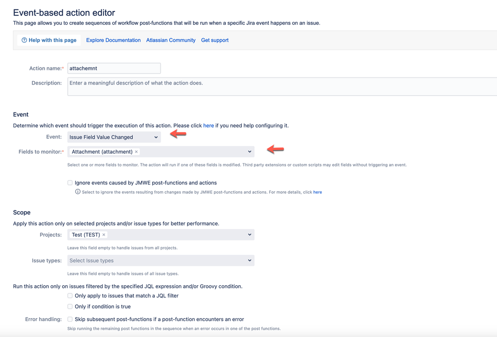

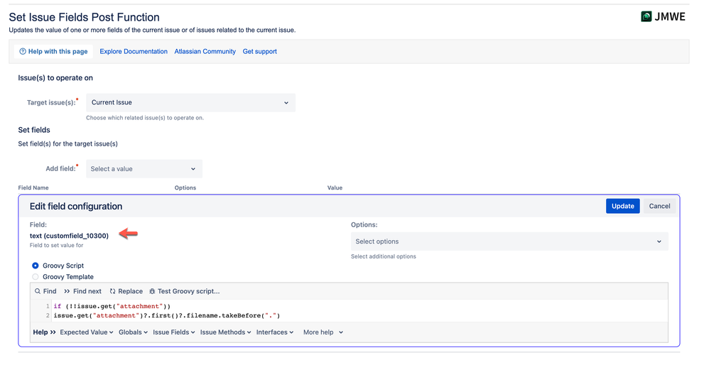

Using JMWE's Event Based Actions you can add the Event-based action
1. Select the Event: Issue Field Value Changed
2. Select Attachment under the Fields to monitor section
Under Post Functions, add the Set Issue Fields Post Function and select the text field that you want to update and add the below script:
if (!!issue.get("attachment"))
issue.get("attachment")?.first()?.filename.takeBefore(".")
When an attachment is added, you will see the value being updated with the file name without the extension.
If there is more than one attachment, the script takes the first attachment into consideration.
Hope this helps!

Reshma Begum {Appfire}
August 16, 2023
Hi @jira_admin_cu ,
Thank you for giving it a try!
To check for a specific attachment name, modify the script as shown below
if (!!issue.get("attachment") &&
issue.get("attachment")?.last()?.filename.startsWith("peer") == true)
issue.get("attachment")?.last()?.filename.takeBefore(".")
 Please let us know if this meets your requirement.
