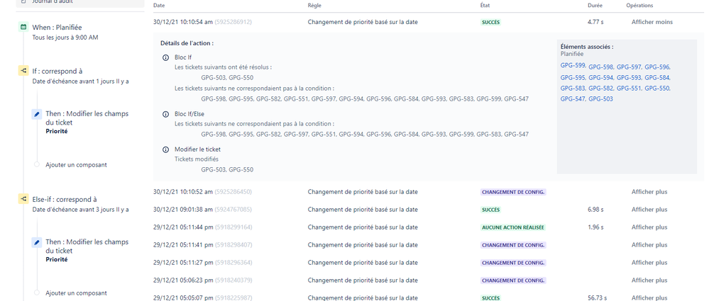

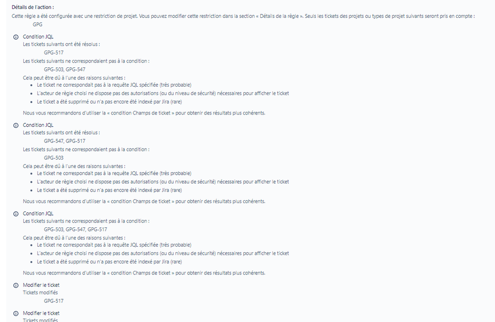

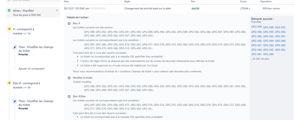

Vincent
December 30, 2021
Here's my latest attempt based on someone that tried the same thing : jira1.PNGjira 2.PNG
And the audit log (in french unfortunately)

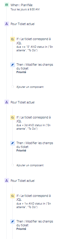

Vincent
December 30, 2021
And here's another attempt :jira 3.PNG
