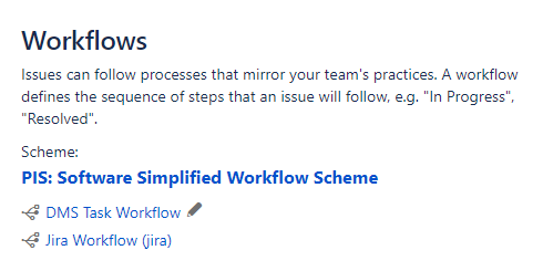

I have changed the workflow of a software project which was already started. In fact I have associated workflow which we have defied on our own for Epics, Stories, Tasks and Subtasks. For the issues (bugs) we have associated the default Jira Workflow. After I have done that all things went well as I expected, except in the project backlog it has listed all the issues/ Stories ect which we have completed over the past completed sprints.

Also remember that since you now have two different workflows in your project that if you have changed the statuses, then you are going to get a bit more difficulties in the mapping of your board columns.

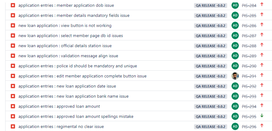

However now I have another issue where when we have completed (arrive to final state of workflow) a task\ issue Jira is not marking it as completed task by putting right mark and strike through the issue number. Can you help me out please

In your new workflow did you set the issue as resolved in your final step?
You need to do this either by calling a screen to set the resolution or to set the resolution automatically by setting it with the post function in the transition.

Hi Krister, by following above steps I was able to resolve my issue.  So thank you very much for the help you have provided over this.
