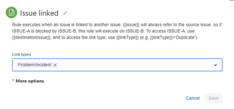

to create the trigger this is the screen:
Something here says..... the issue B will be updated, but i want to update My case, not the case from others.
It says also... to access Access ISSUE A use {{destinationissue}}...... Here is my gap.
How can i use this?
Here in this menu can't find anything, so moving forward....

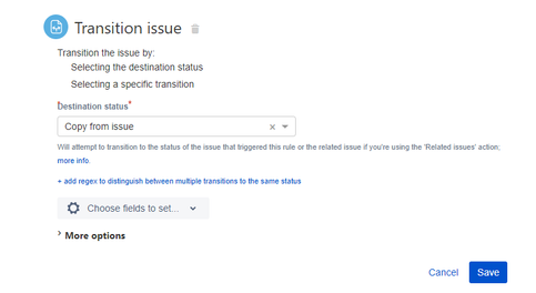

next step is to create the action:
Again... *Destination Status*
But i want to set the status for my case, not for the destination case.
Probably I need to use the "{{destinationissue}}" instruction, but d'nt know how.

Hi @Humberto Gomes
You can achieve this using a Branch rule/related issues
When using the trigger Issue Linked, the source issue is always assumed to be the issue that needs to be receive the action. This is often the issue which has the outward description attached (blocks, clones, etc)
To action against the destination issue (is blocked by, etc):
  1. Add a Branch
  2. Select the type of related issue as "Destination Issue"
  3. Continue your rule's actions, etc within the Branch
There's a good blog post on this topic - see it here
