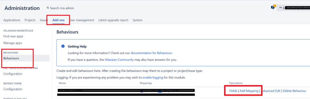

Hi @Jens Jensen,
you need to create a new behaviour (Add-ons -> Behavihours) and associate it to your project/issue type (use "Add Mapping"). Afetr doing that, you need to add your field (use "Fields" link) "Template" and put my code there.
