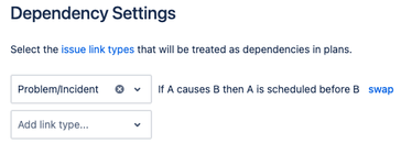

Yes, that can be changed if you go to Settings > Products > Advanced Roadmaps dependencies. From here you can set the default link type and also add more if needed.

Hi @Mikael Sandberg  - Can you provide a screenshot of how to do that? Because I don't see a way to do it. I have changed the order of the issue links, but it always defaults to the alphabetical one first no matter what the order.

Hi @John Funk,
So it only work if you have a single dependency specified. I you have multiple it will pick it based on the alphabetical order as you discovered.
