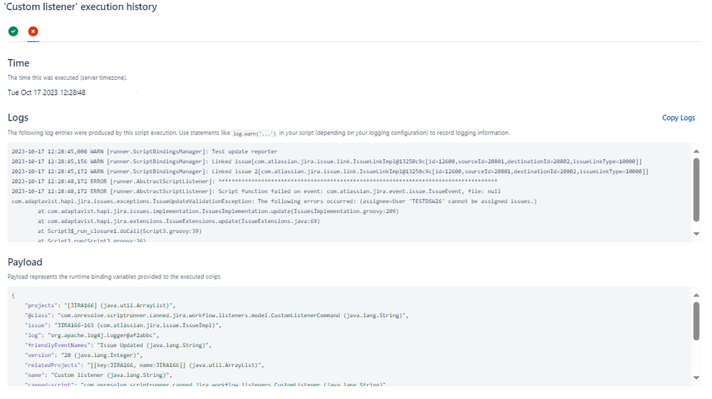

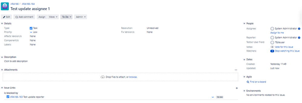

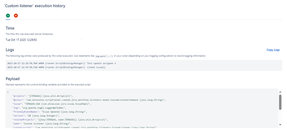

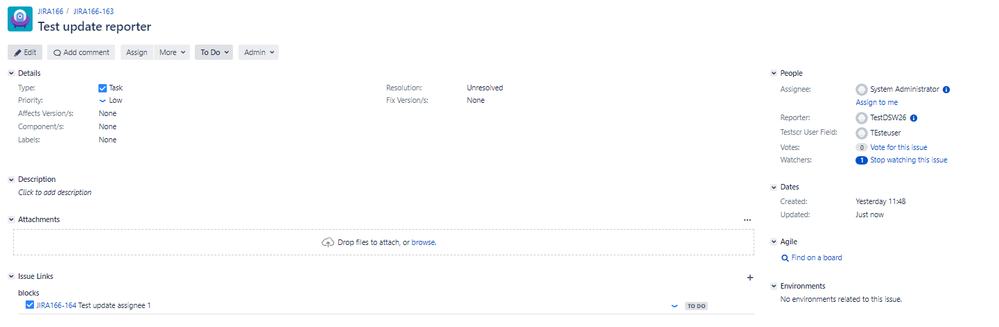

I can't understand why I get an error in one case and an empty list of related tasks in the other case.
The script is like this:
def issue = event.getIssue()
def issueKey = issue.getKey()
//def issue = Issues.getByKey('JIRA166-163')
def issueSummary = issue.getSummary()
def orgIssueReporter = issue.getReporter()
def linkedIssues = issue.getOutwardLinks()
log.warn(issueSummary)
log.warn("Linked issue" + linkedIssues)
linkedIssues.each { it ->
    def linkedIssue = it.destinationObject
    log.warn("Linked issue 2" + linkedIssues)
    linkedIssue.update{
       setAssignee(orgIssueReporter)

Hi @Max ,
In one example, the user does not have permission to be an assignee in this project.
And on the other hand, you would have to add the InwardLinks to the linkedIssues (unfortunately there is no function in HAPI that gets all the links). You can simply add both lists together:
def linkedIssues = issue.getOutwardLinks() + issue.getInwardLinks()
