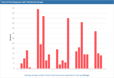

I have a wallboard with a chart that shows a Time To First Response widget.
The widget looks like this for a 30 day period:
Great!

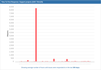

When I configure the same widget for a 300 day period, then the chart looks like this:
Not so great... :-(
What happened: in week 28 of 2018 we ran an Automation for Jira rule that deleted attachments from closed issues after 30 days of inactivity, and added a comment to explain why they were deleted (because of GDPR compliance).
A typical JQL for one week, represented by one bar in the chart, would be
project in (SUP, TSALES) AND cf[10900] >= 2018-07-01 AND cf[10900] <= "2018-07-07 23:59"
Now, the problem most likely is that not all issues already had a value in the field cf[10900], but did already have comments from before that field was added. When the Automation rule ran, cf[10900] was suddenly filled in for these issues, with a value of the comment added by the Automation rule, not with the date of the actual first comment. That's how the spike got in there, and it makes the chart rather useless.
To fix this, I would have to:
  • if the value of cf[10900] is not empty OR
    • if the value of cf[10900] is empty AND
    • the issue has comments that are not by the reporter
  • change the value of cf[10900] to the date of the first comment that is not by the reporter
How do I do that? I suppose I need to update it directly in the database? I do have database access if needed.

Amedee Van Gasse
February 20, 2019
You know what? Never mind. I looked into the details of the issues in the spike, and most of them were added by an internal user, who used them to track their own progress. So Reporter and Commenter were always the same. That can't be solved. So we'll have to live with it.
