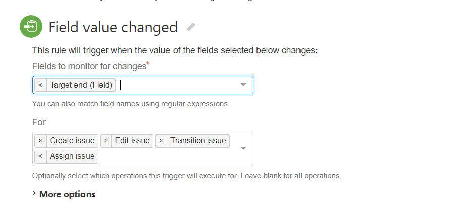

I'm trying to set an automation up for JIRA dashboard and here is what I would like to achieve:
Trigger: changes to Target End Date will trigger this automation
Setup: the link issue type between milestones and initiatives are "is contributing to" and "contributes". For each milestone, there will be multiple initiatives.
Condition: compare the Target End Date of these multiple initiatives within a milestone and only the one whose target end date is furthest into the future will be used to compare with the Target End Date of the milestone. If initiative is 15 days later than milestone, then the RAG indicator will turn red.
What I have written for the condition and it doesn't work: [initiative.target end.max].diff(intiative.parent.target end).Days

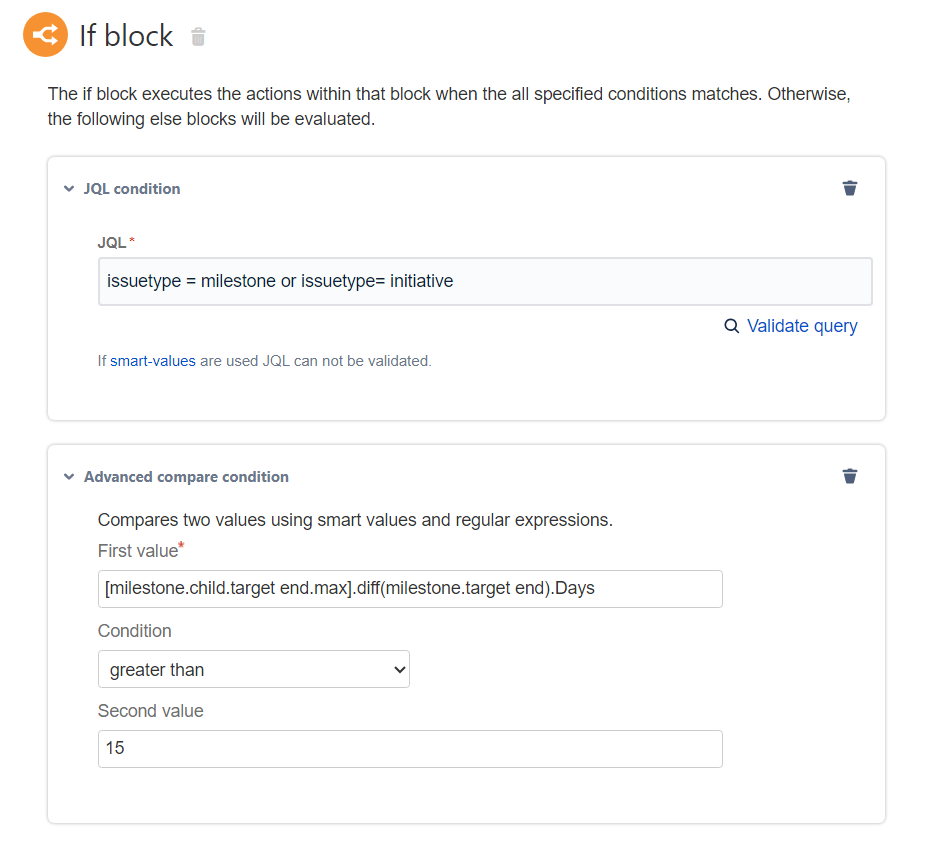

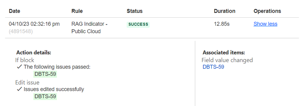

Wendy
October 9, 2023
Hello Bill,
Thank you very much for your answer. I have tried the method mentioned by the above links but still failed.

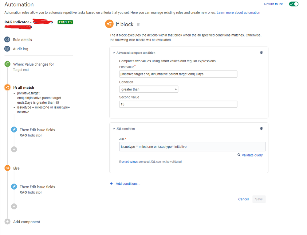

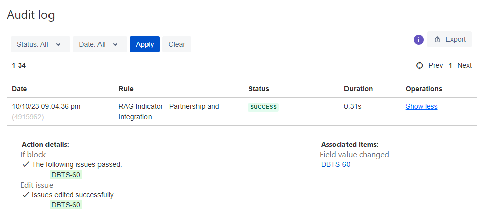

The Target end date of DBTS-59 is Dec 21 2023 and the target end of the milestone is Dec 13 2023 but DBTS-59 RAG indicator still turned red. Could you please kindly help? Thank you very much!

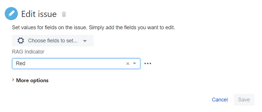

Automation log .pngAutomation Rule .pngAutomation Rule 2.pngAutomation Rule 1.png

Wendy, would you please post an image of your entire rule showing all of the steps?  That will provide some context to help explain what you are observing.  Thanks!

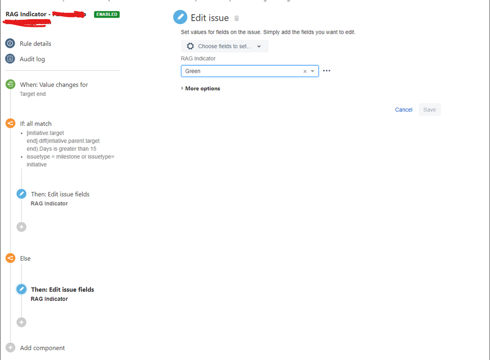

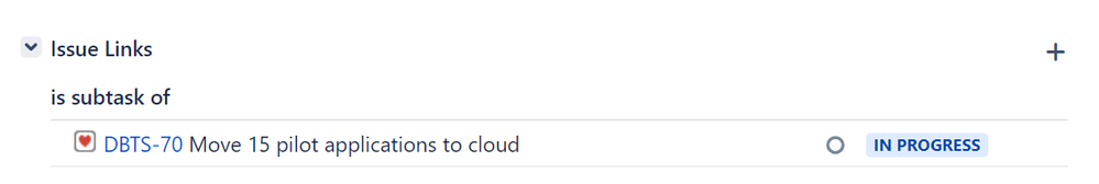

Wendy
October 10, 2023
Hello Bill,

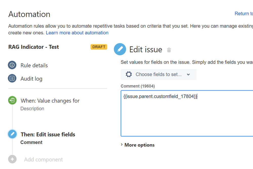

The above screenshot is the whole set up of the rule. I have tried to debug by setting up another rule and edit the comment to see if i am able to get any data from it. but it turns out that i cannot extract any data from {{issue.parent.customfield_17804}}. That's why the above calculation of days does not work.
From this link i understand that parent can only work when the issue is a sub-task. However, i have set the initiative as a subtask for the milestone (please find the picture below). Is it because the way i set the subtask is wrong? Could you please advise? Thank you!

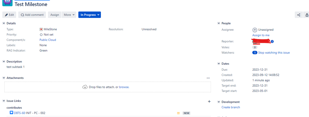

Wendy
October 10, 2023
Hello Bill,
Thanks a lot for quick reply and new questions. :)
Here are the answers to the questions:
  • Which product are you using?  - JIRA Cloud
  • And if using Jira Cloud, what is your license level: free, standard, premium, or enterprise?  - Enterprise

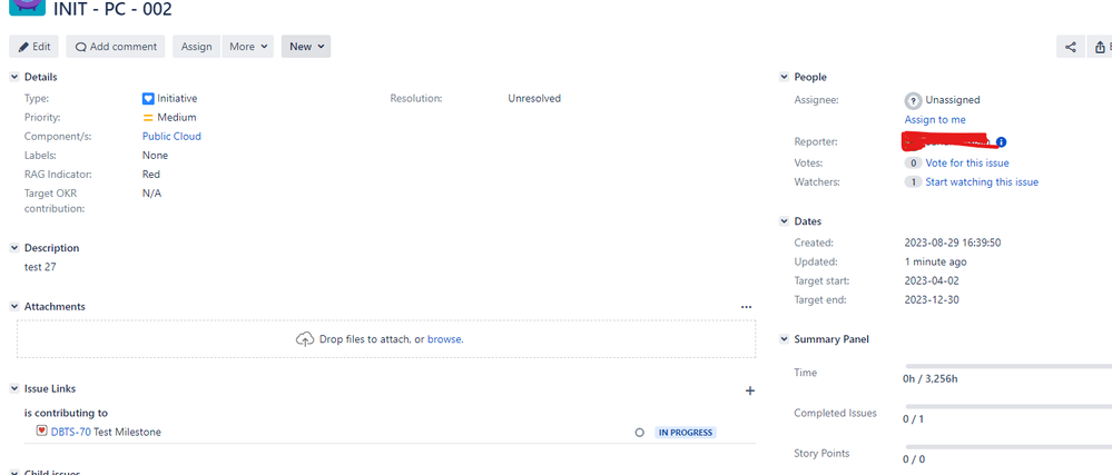

  • What is your issue hierarchy and the issue types you are using in the rule? - Issue types: initiative and milestone. Issue hierarchy: contributes and is contributing to (please kindly find the attached pictures for the two issues)
Here are screenshots of the rules, issues and logs.

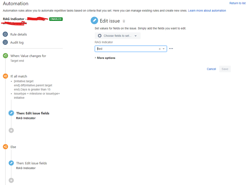

rule 20231010.pngrule 1 20231010.pngRule 2 20231010.pngRule 3 20231010.pngrule 4 20231010.pngRule 5 20231010.png

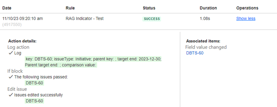

Bill Sheboy
October 10, 2023
Thanks for those additional details.
I do not see any handling for the relationship between the issues (which I thought used links and/or the "parent link" fields for your version) in the rule, so I am assuming you are handling that all with the parent field.
Let's try this: immediately after the trigger, add a Log action to write this to the audit log:
key: {{issue.key}}; issueType: {{issue.issueType.name}}; parent key: {{issue.parent.key}}; target end: {{issue.target end}}; Target end: {{issue.Target end}}; comparison value: {{issue.Target end.diff(issue.parent.Target end).days}}
That will confirm the issue you are triggering the rule with, the correct smart value for Target Date, and if a parent is present, what is the date difference.
Wendy
October 11, 2023
Hello Bill
Here is the log details
Log:
key: {{issue.key}}; issueType: {{issue.issueType.name}}; parent key: {{issue.parent.key}}; target end: {{issue.target end}}; Parent target end: {{issue.parent.Target end}}; comparison value: {{issue.Target end.diff(issue.parent.Target end).days}}
Bill Sheboy
October 11, 2023
From the log you can see the parent field is empty for that issue, DBTS-60.  Was that expected to you?
I suspect your rule will need different processing for Initiative versus Milestones to do what you wanted, as only one of those issue types will have the parent field set.
