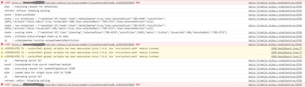

I have recently started seeing a similar problem with an Scrum board when drag-dropping issues to reorder them or assign to different versions or epics. I don't think it is addin-related (no new addins), but it possibly happened when Chrome updated to V 75.0.3770.100 (64-bit).
I am using Jira Server v8.2.1.
The Chrome developer console shows the messages in the screenshot below.
Andrew
