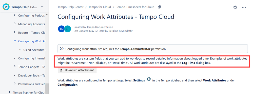

Hi @Robbie Pannell ,
I saw the following instructions in Tempo Timesheet:
I think you can try it out to see if you can meet your needs.
