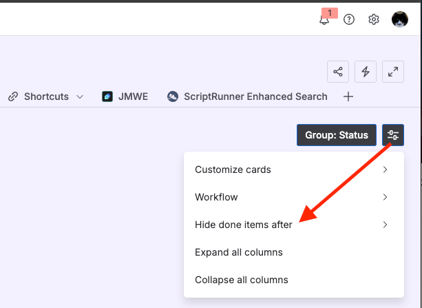

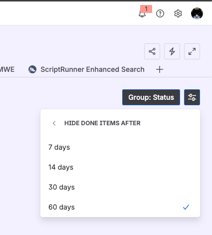

In a Business project the Board display will automatically hide issues that have been completed when they reach a certain age. You find that setting here when viewing the project's Board.
Screenshot 2025-11-20 at 7.52.03 AM.pngScreenshot 2025-11-20 at 7.52.30 AM.png

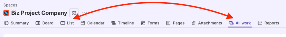

If the users have appropriate permission to view all issues, and all issues migrated successfully, then they will be able to get the list of all issues using the Search For Items option under Filters (in the navigation panel on the left), or by selecting the List tab within the project, or by selecting the All Work tab within the project.
