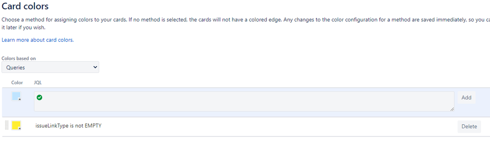

Heather Walden
February 14, 2022
I tried issueLinkType is not Empty and it turned all my cards to the color strip yellow even if they don't have a link. I think something is broken in JIRA.

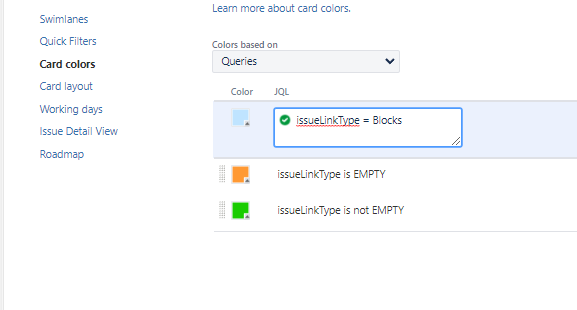

Can you post a screenshot of what you're doing in that field?  If you have any logic in the card colors field, you'll get card colors for all of them (one for the query, and one for anything that doesn't match the query).
In my case, I have one card color for when IssueLinkType is not EMPTY (Red), and all the other cards get a grey color strip.
Heather Walden
February 14, 2022
I just want cards to have a color strip only if linked to another issue. I don't want a color on other cards but all my cards turn yellow with this issueLinkType is not EMPTY, even if they do not have a linked issue. I do not have any other queries for colors set up. Thanks for your help.

Just to confirm, you have NO linking on the other cards?  No Epic link, no parent link?  What color are they turning (mine also change to a grey color for anything outside the query parameters I have set out for my project).
Heather Walden
February 16, 2022
The cards all have epic links but not all have linked issues. I'm trying to have a color on the cards only if they are linked to another issue. I have no other queries set up and all are turning yellow.
Chris Buzon
February 16, 2022
In that case you'll have to set up the query to explicitly look for all the link types by name.  Epic links and Parent links are a type of link, so it will consider them as Linked, and will therefore color the cards.
For example, try  "IssueLinkType = Blocked OR IssueLinkType = Relates OR ..."
One other thing - links are 2 way - so even if you select "Blocks", if you can see the linked ticket on your board (which will have "blocked by" as the link type), it will also color it.
