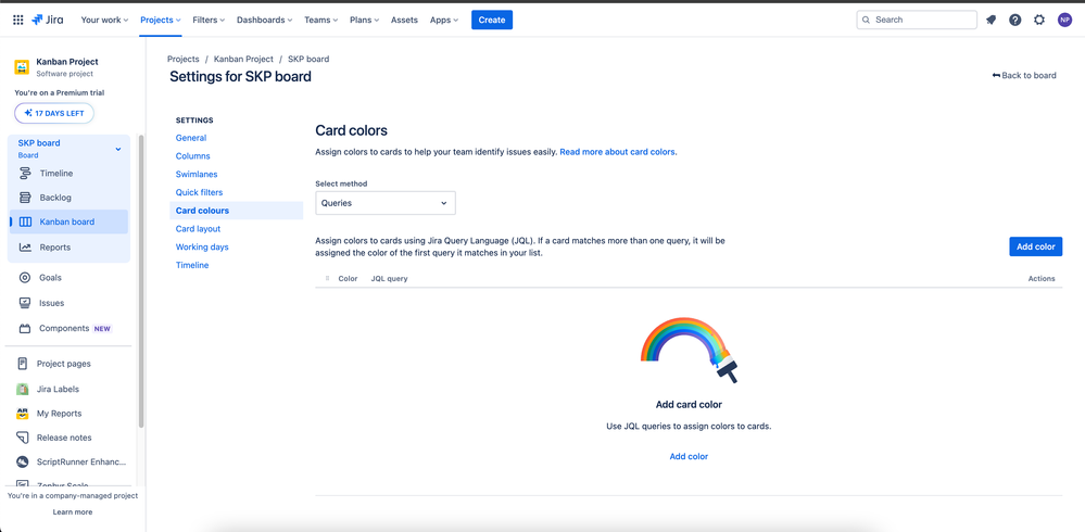

Nikola Perisic
February 7, 2024
Hello @Eric Haas
You can do this by selecting the method of queries:
Based on a JQL query you can define the color of start and the end dates.
Eric Haas
February 7, 2024
Hi @Nikola Perisic
Yes, thanks a lot...!
I know where to define it... but - at least for me 🤔 - I can't define a formula similar to this:
("end date" - "start date") > 90d
Maybe I just don't get it?
Or do I need an additional custom field first which calculates the difference of the dates?
