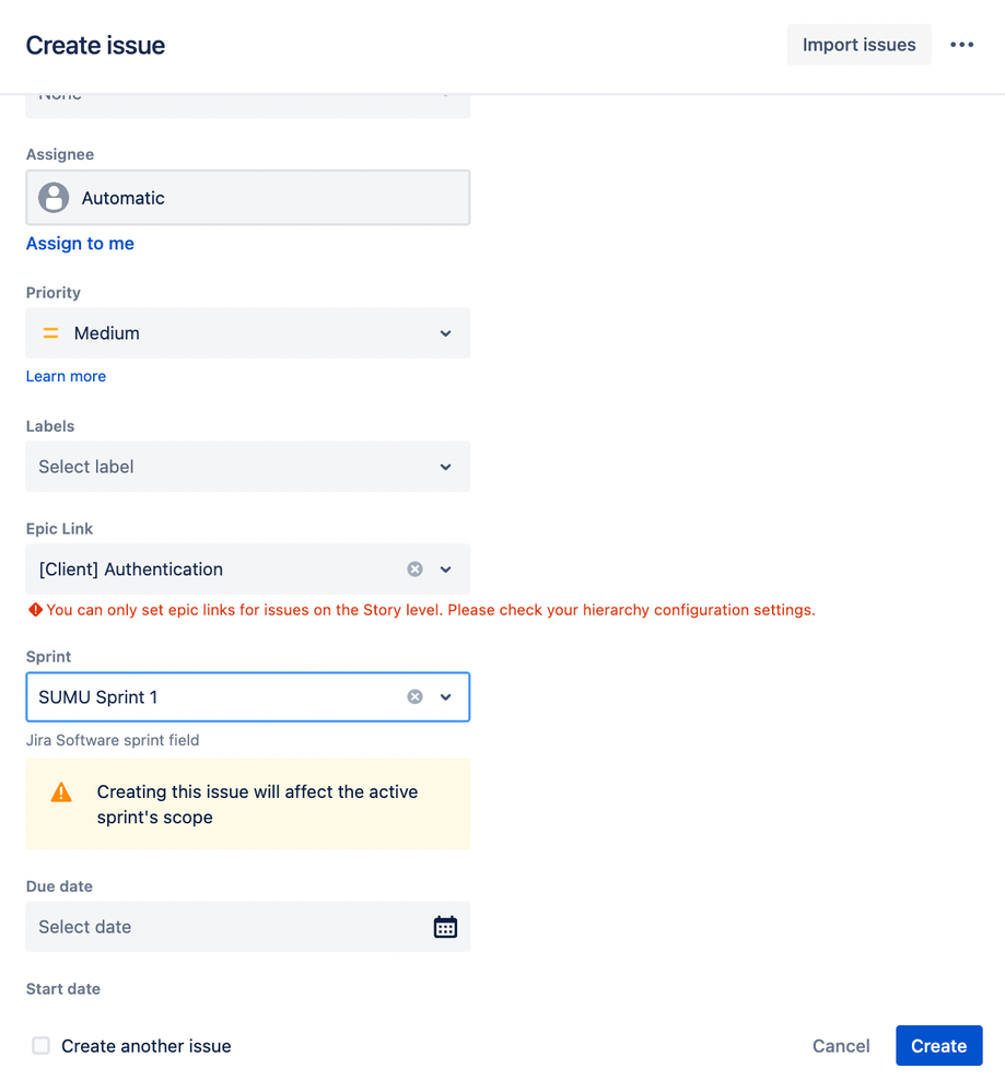

Hi Community,
Much user on my company cant link their task to epic there is error message "You can only set epic link for issues on story level"
What I must do and how to solve this

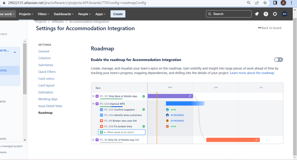

Arief Ramadhan Heldian
June 22, 2022
Currently we use advance hierarchy roadmap on our cloud.
I check on their project board setting roadmap already disable
Any advice for fix the issue ?

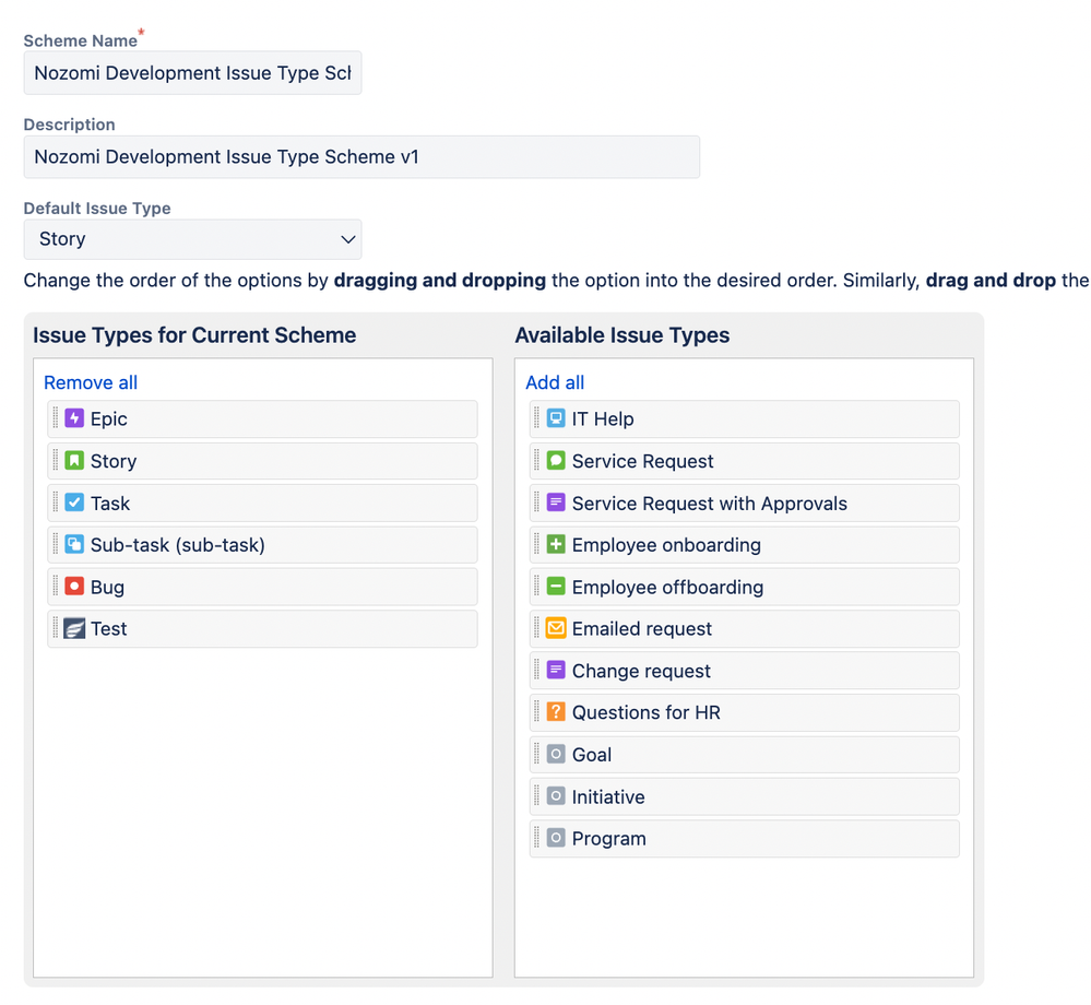

Ivan Stasialovich
June 27, 2022
Hi @Chu Dam !
I'm facing the same issue right now(prev week everything was good and we didn't change anything in settings)
And here you can check our hierarhy

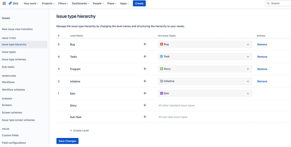

Chu Dam
June 27, 2022
Hi @Ivan Stasialovich
Your issuetype config seems good, now please check your custom hierarchy levels to your Advanced Roadmaps plan:
If an issuetype that you want to create is missing in the hierarchy levels on your Advanced Roadmaps config, then you can't link this issuetype to epics...
This is weird but check the hierarchy levels on your Advanced Roadmaps config please, just to be sure that everything is ok there...
Let me know ;)

Ivan Stasialovich
June 28, 2022
@Chu Dam Hi again, thanks for your replay!
But unfortunatly I already have both story and epic here. (I'm trying to create a story and connect it to the epic in my prev message)
Chu Dam
June 28, 2022
@Ivan Stasialovich I think there is a problem in your hierarchy here... Story issue type maps to Program...

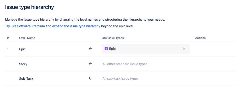

Here is the default issue type hierarchy of Jira Cloud
Linking any issuetype to Epic is working perfectly fine... try to review your hierarchy config but before doing that inform people cause it can have an impact on Roadmap plans and all...

Ivan Stasialovich
June 28, 2022
Thanks @Chu Dam , that helped!
