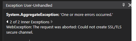

Hello,
I am using the API to get an attachment but it is generating an error of "Request aborted: SSL/TLS not supported"
 ServicePointManager.Expect100Continue = true;
//ServicePointManager.SecurityProtocol = (SecurityProtocolType)3072; //use TLS 1.2
ServicePointManager.SecurityProtocol = SecurityProtocolType.Ssl3 | SecurityProtocolType.Tls | SecurityProtocolType.Tls11 | SecurityProtocolType.Tls12;
ServicePointManager.ServerCertificateValidationCallback += (sender, certificate, chain, sslPolicyErrors) => true;
var client = new RestClient("https://selfdeploy.atlassian.net/secure/attachment/27100/****");
var request = new RestRequest(Method.GET);
request.AddHeader("Content-Type", "application/json");
request.AddHeader("Authorization", "Basic **********");
IRestResponse response = client.Execute(request);
Is there something that I am doing wrong ?
Can someone help please ?
 Thanks in advance

Hi @Ismaël Ayoub ,
If I understand correctly you are able to call other JIRA Cloud REST API endpoints but you get an error when you try to download attachments.
However, from above code it is not possible to understand what you are doing and there are chances that the error message is misleading (the problem might be somewhere else). It can indeed be the case that your call is failing to follow the redirect url and therefore to create the channel, but there is nothing wrong with the way you set the TLS protocol in your code.
Therefore, in order to proceed:
  1. Make sure you are following redirects
  2. Check what happens if you do not specify the protocol (some of the url you are redirected to are also accepting TLS 1.3)
  3. If nothing works:
    1. let us know which endpoint(s) you are calling
    2. Try to call the same endpoint(s) using Curl and paste the output in here.
For example, on my side as long as I follow redirects everything works whether I specify the TLS protocol or not:

The response that I got is :
I don't know if I am doing something wrong or there is a something I am looping. :(

Hi @Ismaël Ayoub ,
In the Curl output I can see 2 different errors:
  1. Your system seems to be unable to find the certificate verify location (where the trusted certificates are stored on your machine) and therefore it is closing the connection :
    * error setting certificate verify locations:
    CAfile: /etc/pki/tls/certs/ca-bundle.crt
    CApath: none
    * Curl_http_done: called premature == 0
    * Closing connection 0
  2. You use -0 (zero) instead -o (output) and therefore curl thinks that's the url to contact:
    * Rebuilt URL to: test.xlsx/
    * getaddrinfo(3) failed for test.xlsx:80
    * Couldn't resolve host 'test.xlsx'
    * Closing connection 1
    curl: (6) Couldn't resolve host 'test.xlsx'
Now, it can be that there is a problem with the certificate storage path on the machine where you are running the test from, but if this is the case then you shouldn't be able to connect to any other REST API endpoint as well.
Also, please notice that once again the provided code does not help since is not showing the endpoints called or the logic followed.

 In my code I have put a condition like:
if(response2.StatusCode == HttpStatusCode.MovedPermanently || response2.StatusCode == HttpStatusCode.Found)
// take the response2.Headers.Location and GetAsync from the URL.
In doing that, I still got the first error from my first post.
Can you help please ?
Thanks in advance.
Ismaël

Hi @Ismaël Ayoub ,
From the pasted output I can see that you were able to successful download the file using curl (following redirection). This means the REST API endpoints are working as expected and the problem is with the way your code tries to handle this situation.
Now, I don't know C# much but by searching a bit I have found the below thread in Stackoverflow that says you should use HttpWebRequest.AllowAutoRedirect Property:
The example in there shows:
HttpWebRequest myHttpWebRequest=(HttpWebRequest)WebRequest.Create("http://www.contoso.com");
myHttpWebRequest
.MaximumAutomaticRedirections=1; myHttpWebRequest.AllowAutoRedirect=true;
HttpWebResponse
myHttpWebResponse=(HttpWebResponse)myHttpWebRequest.GetResponse();
Please review above thread (and the links in there) and see if this helps.
Finally, for the future, kindly notice that this might not be the best place to get help on development  related questions. In case further help will be needed on this topic, you might want to refer to the resources listed in https://developer.atlassian.com/resources. Specifically:
Cheers,
Dario
Ismaël Ayoub
November 26, 2019
Hello @Dario B
Well I no longer get the issue now as it has been solved by itself.
I suspect that there was an issue with the certificate which caused the bug.
Many thanks for your support on this matter and I take your notice on the development related questions.
Thanks,
Cheers,
Ismaël
