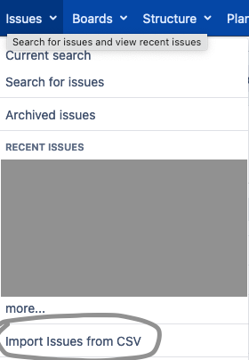

1. access via Issues in the tool bar

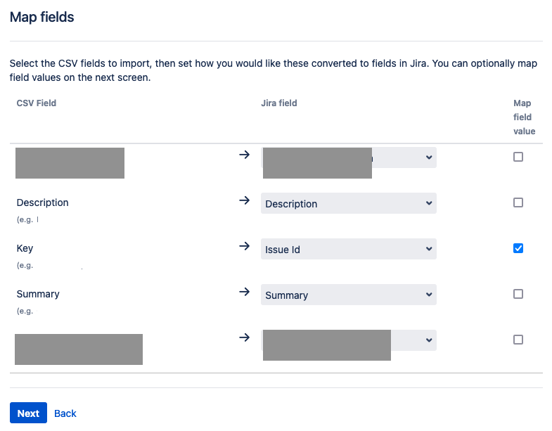

2. map the issue key

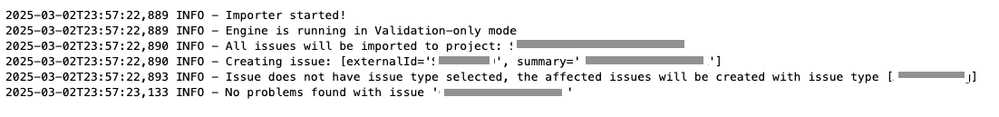

3. It creates a new ticket with the log below. Screenshot 2025-03-03 at 00.08.05.png

Hi Hannah - Welcome to the Atlassian Community!
You should map to the Issue Key instead of the Issue ID. You can call it whatever you want in your CSV file, but it checks the Issue Key field to see if that value already exists and if it does then it does an update instead of a create.
Hannah
March 3, 2025
It is unfortunately not possible to map with Issue Key. It's not available in the dropdown - not possible to add it neither.

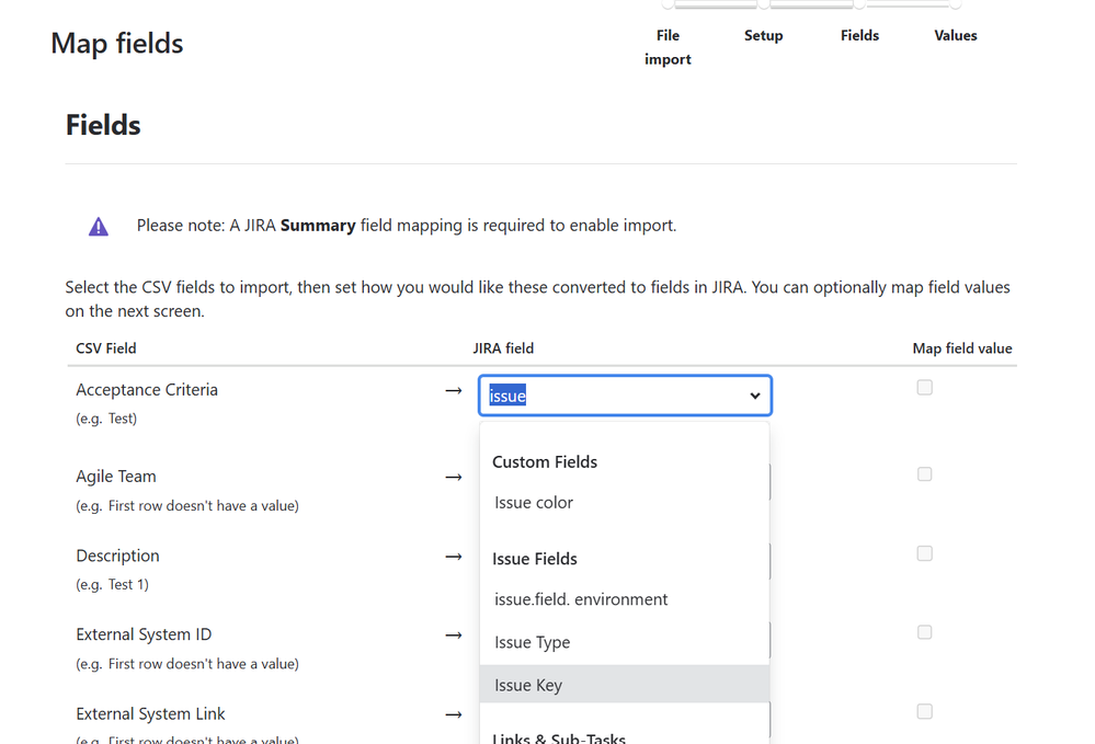

John Funk
March 3, 2025
You should go through the Settings > System > External System Import path
Use the Switch to the old experience link.
As you can see in my example, it shows up there.
