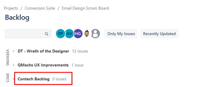

When I try to select a sprint on JIRA automation, cannot see all the sprints.
Sprint on our board:

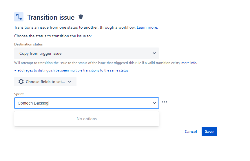

Hi @Emre Parkan
Is that sprint you are trying to select an active or a future sprint?  I wonder if the value is only in the drop-down list once the sprint begins.
You could use advanced edit (with JSON) to try to set the value by the sprint ID.

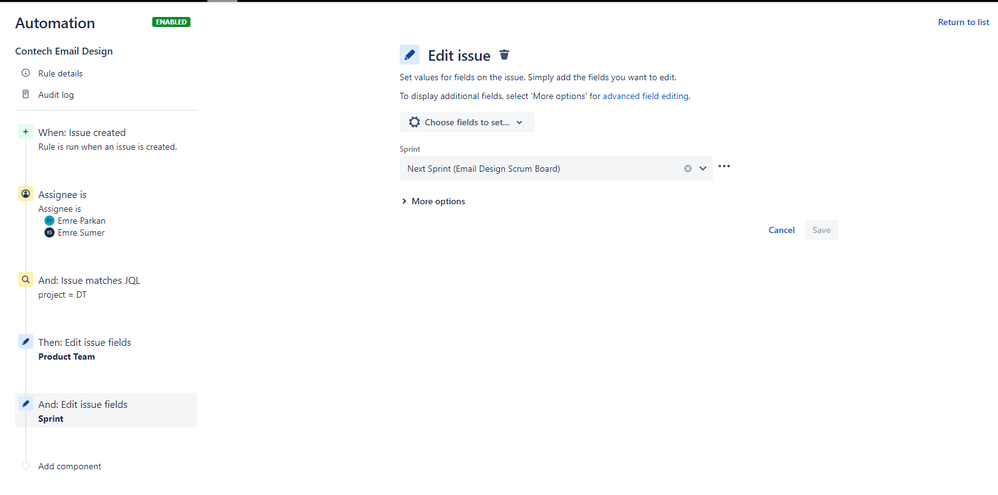

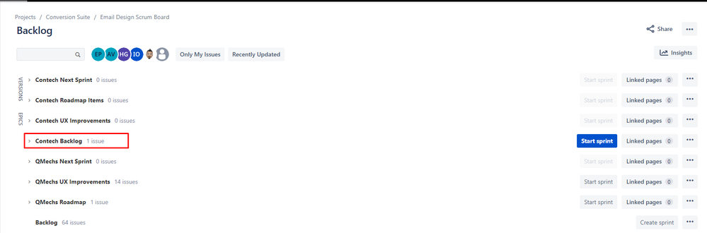

The sprint that I am trying to assign is a future sprint as you can see in the following picture. Screenshot_3.png
Here is my complete workflow: Screenshot_4.png
I think it is a passive sprint as we are not running any sprints on that board yet. How can I make that sprint selectable from the dropdown that I have shared on top

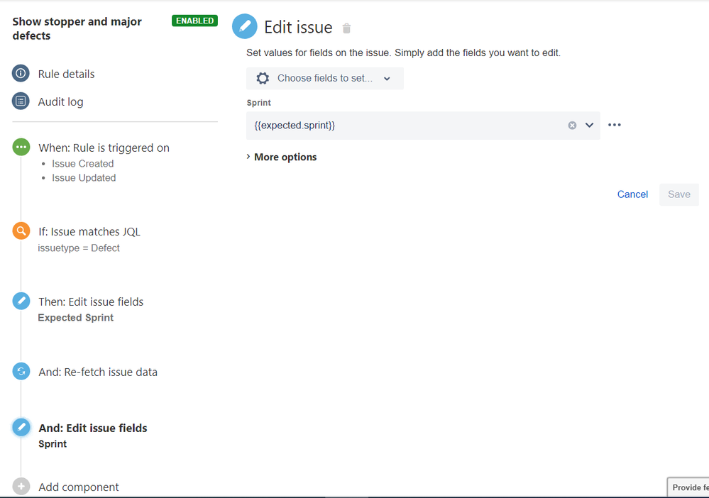

Thank your for a quick response. This is the automation that I am trying to build and below is the error it produces.
I am a bit surprised that the only options I have to choose on the list are Active Sprint or Next Sprint per each Board in this project, but I guess it does make sense as otherwise the rule would have to be updated with each new sprint.
Is there a way to enter a static Sprit value instead? We use a sprint named Show Stopper and Major Defects a a placeholder in the Boards Backlogs, so that it is easy to monitor for these.

The first Edit Issue action seems to be referencing "Expected Sprint", but the second one does not match that.  Instead you are using {{expected.sprint}}  That should probably be {{issue.Expected sprint}} or something like that.

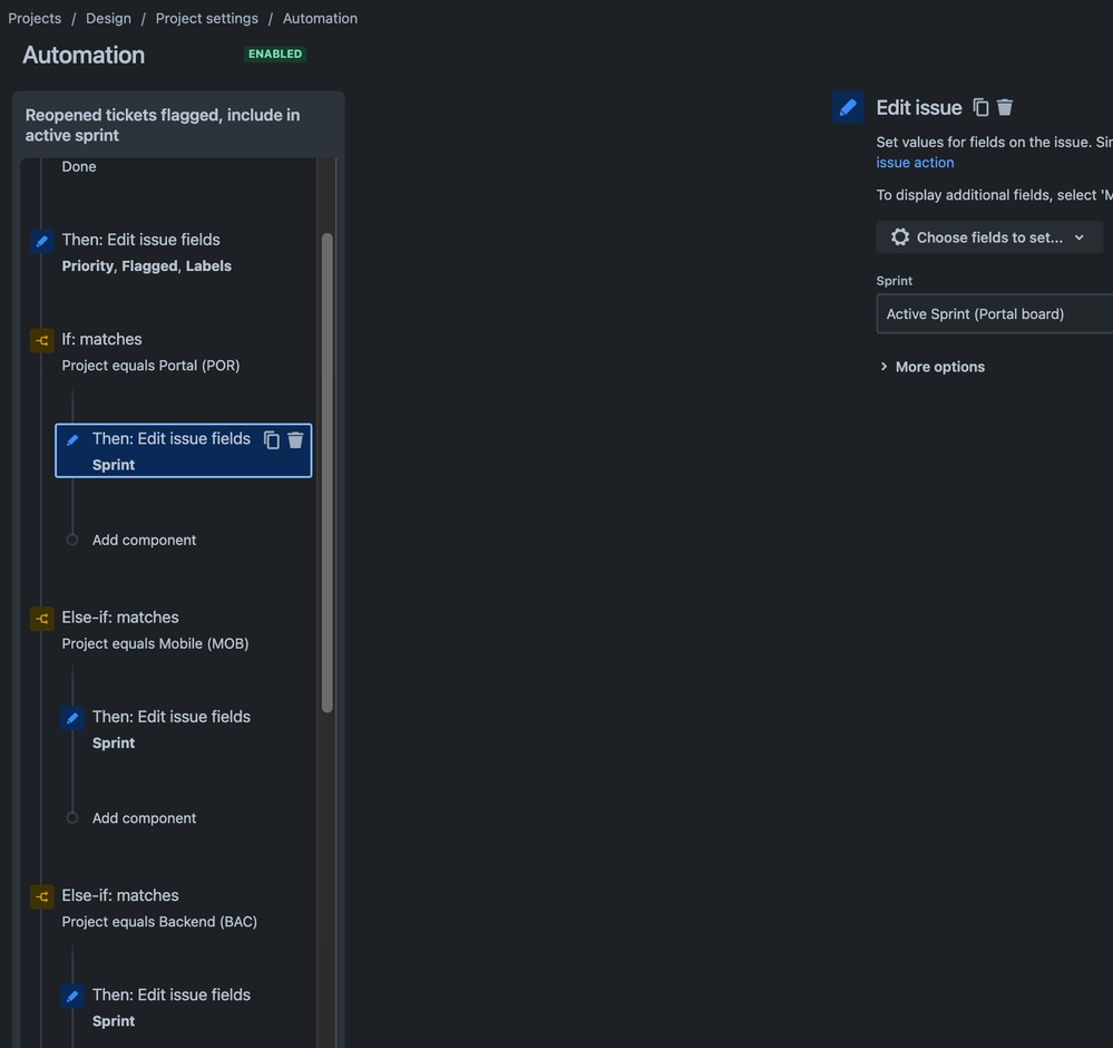

This may only be related in passing, but with Team Managed projects for Jira Cloud, I've found that you need to get to the automation rule editing screen from the project you want to access the sprint of. Otherwise it's not listed.
For example, I have a global automation rule that will put an issue into their active sprint, based on the project key. This is one rule, that refers to multiple sprints on multiple projects. I can have to go into each project, edit the automation rule, set the active sprint for it and save; repeat for each sprint I want to access.
