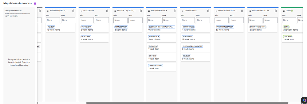

Please share a screenshot from the Board settings > Layout > Columns page showing the mapping of statuses to columns.

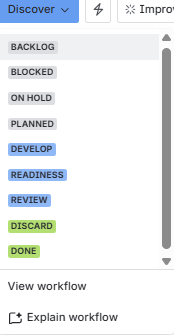

Also please answer the question about whether the user can change the status of the Epic directly by clicking the status button when viewing the Epic details

As for the screenshot, here it is.
They want to be able to move the items into Review L2, and the Post Remediation columns.

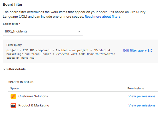

Can you also share with us the JQL for the filter you are using as the basis for the board?

The user can change the PRM item's status to Remediation and Post Remediation when viewing those items directly.
If the status can be changed manually in that manner for PRM issue #2 then PRM issue #2 in the board in the same status as PRM issue #1 should be able to move to the specified columns.
If the status is not available to select manually, then either the Status is not available in the workflow used by PRM or the transition between the starting status and destination status is not present in the workflow.
If the status is missing from the workflow, then yes the workflow would need to be changed. That change would affect every space that uses that workflow.

As for statuses, they see the following statuses in the item:
The statuses mapped to the needed columns are 'Remediation', 'Post Remediation' and 'Everything Else' as shown in the previously shared screenshot.
The JQL is as follows:
