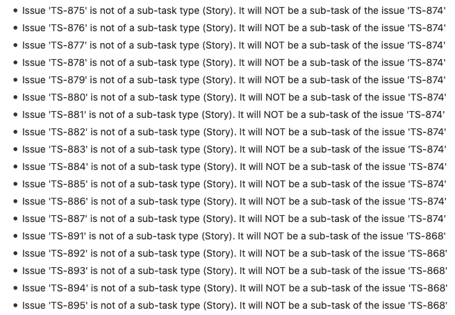

Jira imports the issues correctly, but refuses to add parent/subtask links. This is because it creates all issues as type "Story". Then it complains that "Story" cannot be a sub-task.

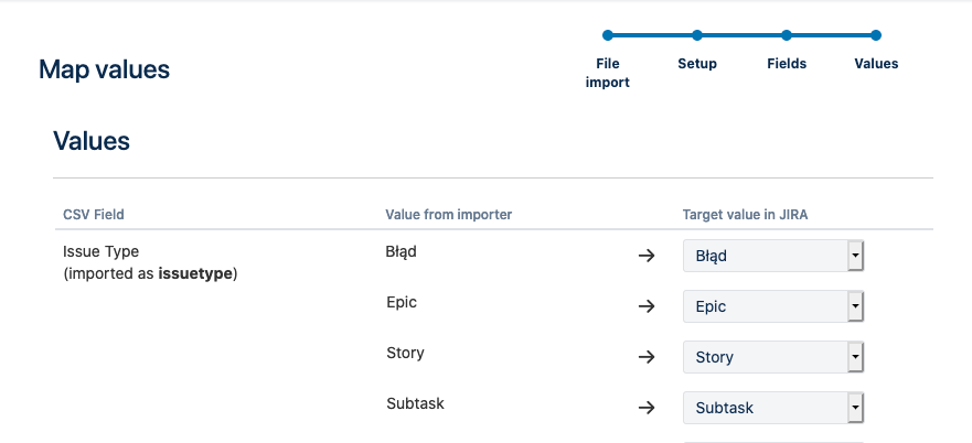

I have tried mapping the values of Issue Type field during import, but the mapping is ignored and all the issues are getting imported as Story anyway.
I have also tried using the exact Issue Type names in the CSV file ("Story", "Subtask") and importing it with default mapping, but I see the same error.

Unfortunately, it is not possible to import sub-task issues to Next-gen projects at this moment because of the following bug:
CSV imports do not map Issue types for Next-gen
