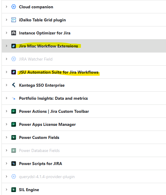

NICOLETTA HADJILAMBI
August 5, 2026
Hi Tobi,
Thank you for your answer. I followed the steps above but I am not able to find the app "Workflow Plugin". This is not in existing apps, and I cannot find it from new apps.
This is what I have:
Tomislav Tobijas
August 5, 2026
When you look at the filter above this list, what's selected there?
In the dropdown menu that typically says "User-installed."
If you select All apps, can you see it then?
I don't have DC environment to actually test this out, so it's all a bit theoretical from my side :/

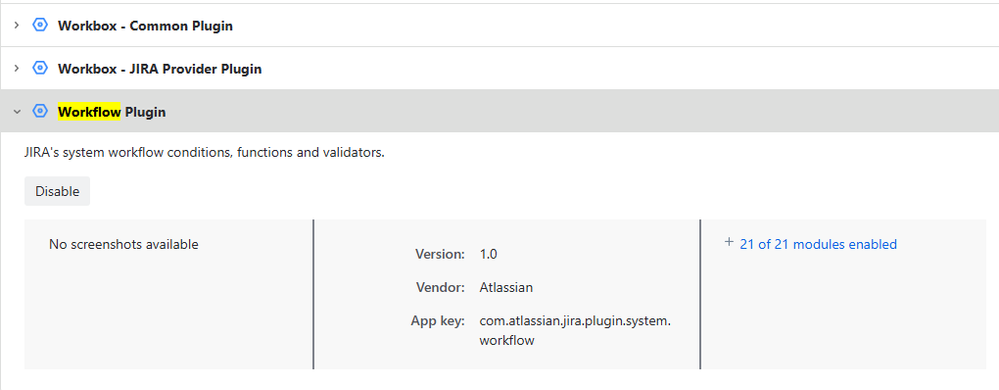

August 5, 2026
I selected "All apps" and yes I can find it, but is already enabled.
