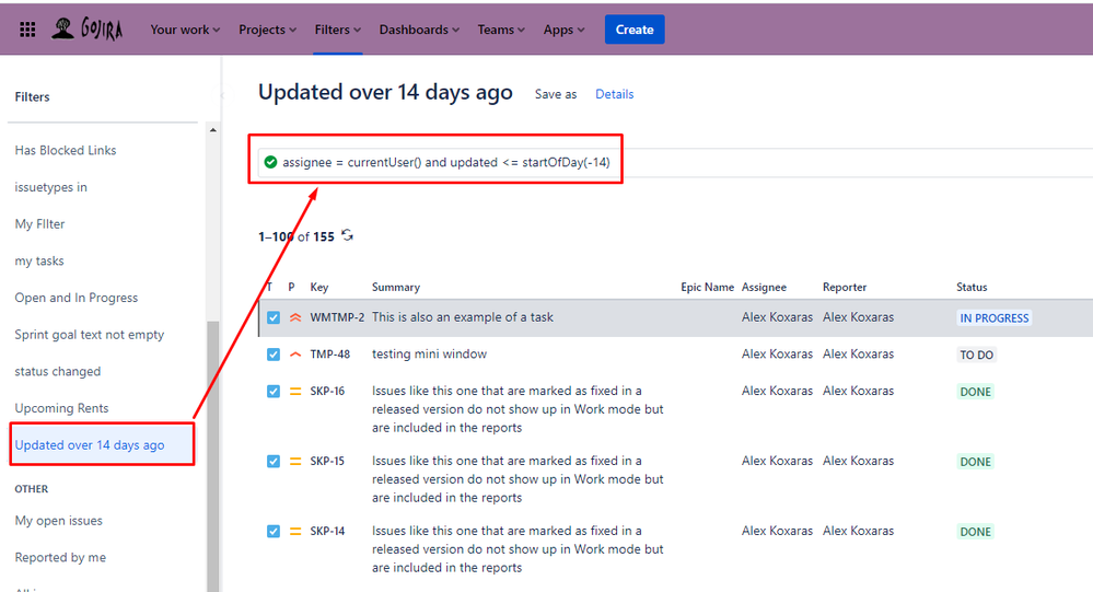

Don't use the Issues screen. Use the Filters screen from the top left menu bar.
That's the solution.

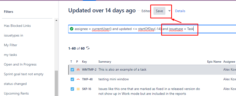

What do you mean "you can't see the definition of the saved filters"? Of course you can see the JQL behind your saved filter, modify it and save it. Did you try to do it?
And I'll take you a step further: Even if you try to change the JQL, it will let you save the filter with the same name:

That's on the Filter page. Which I didn't even know existed, because I was looking for Manage Filters, which does not exist anywhere. While looking for that I found a documentation page that clearly states you cannot edit a filter's content, but did not mention that you could do so from a screen other than the "Edit" button on the filter screen.
Yes, from that screen, if you change the filter criteria, you may notice the button change to "Save." But I am not on that screen.
